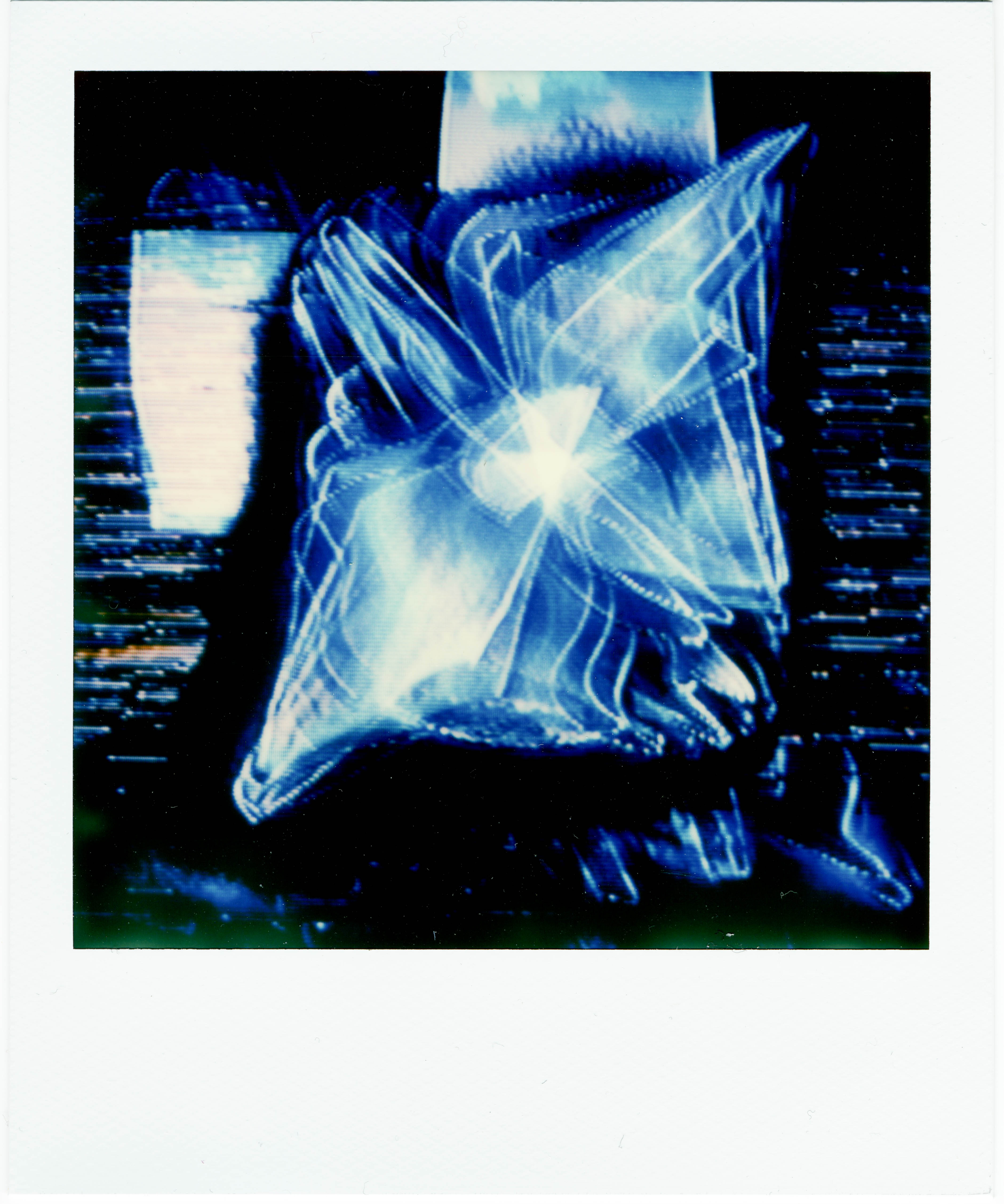

settings are not saving and i’ve experienced the random crash twice, maybe 3 times now. once was during the capturing of this polaroid:
