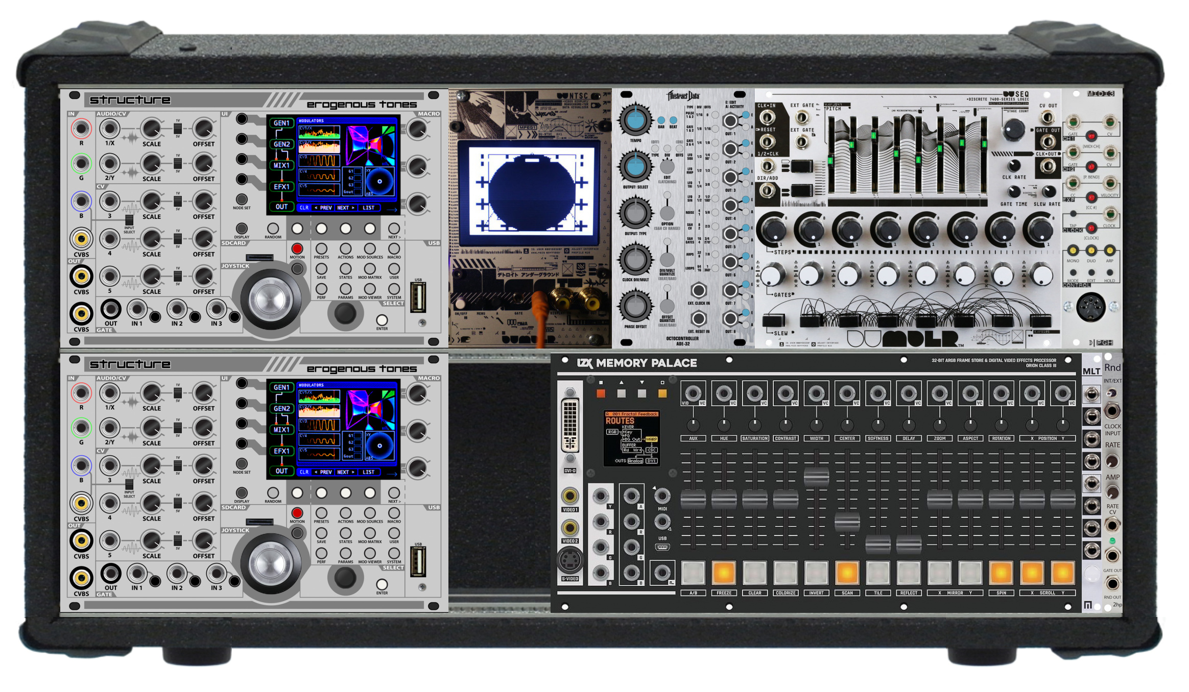

i have a DU-NTSC in the system and when i turn it on the Memory Palace will reboot.
this case has the Malekko Power power in it.
any ideas as to what is going on?
here is a Modular Grid pic of the setup:
a link to the actual rack in modulargrid is 10000 times more useful
I suspect the problem is related to power - maybe you are trying to use too much
doesn’t memory palace have an external power socket? have you tried that?
Hmm. I wonder what the DU-NTSC is doing that the Palace is sensitive to.
