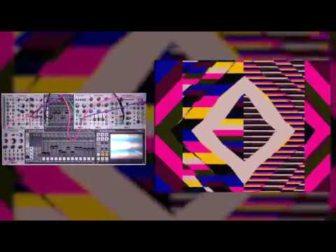

Have you tried following along with the first part of this video?
Pay close attention to trim-pot and slider positions on Fortress and knob positions on Visual Cortex.

yep following exactly this video, the very first patch from osc 1 to the cortex and its happening, this is when i first noticed it
