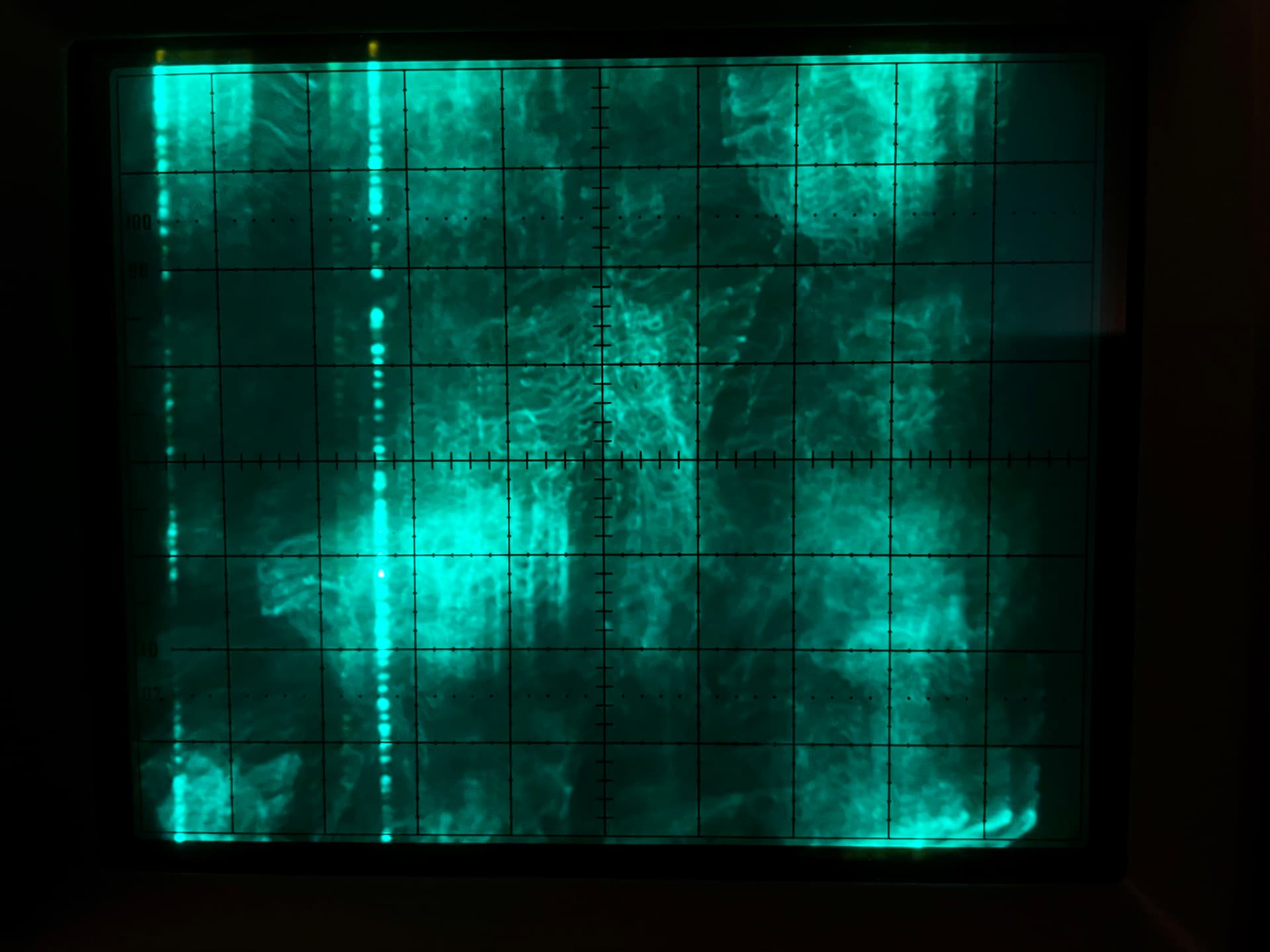

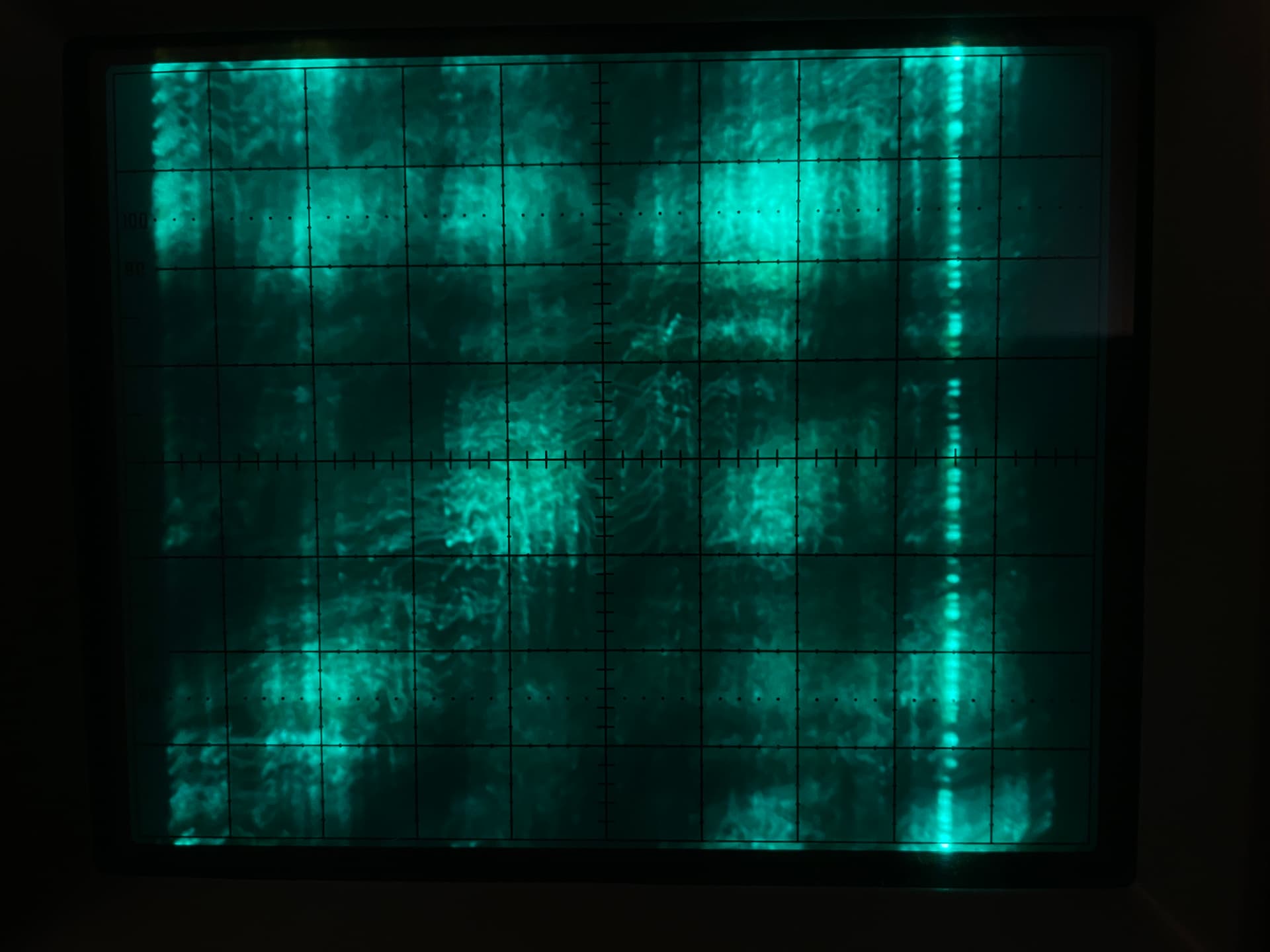

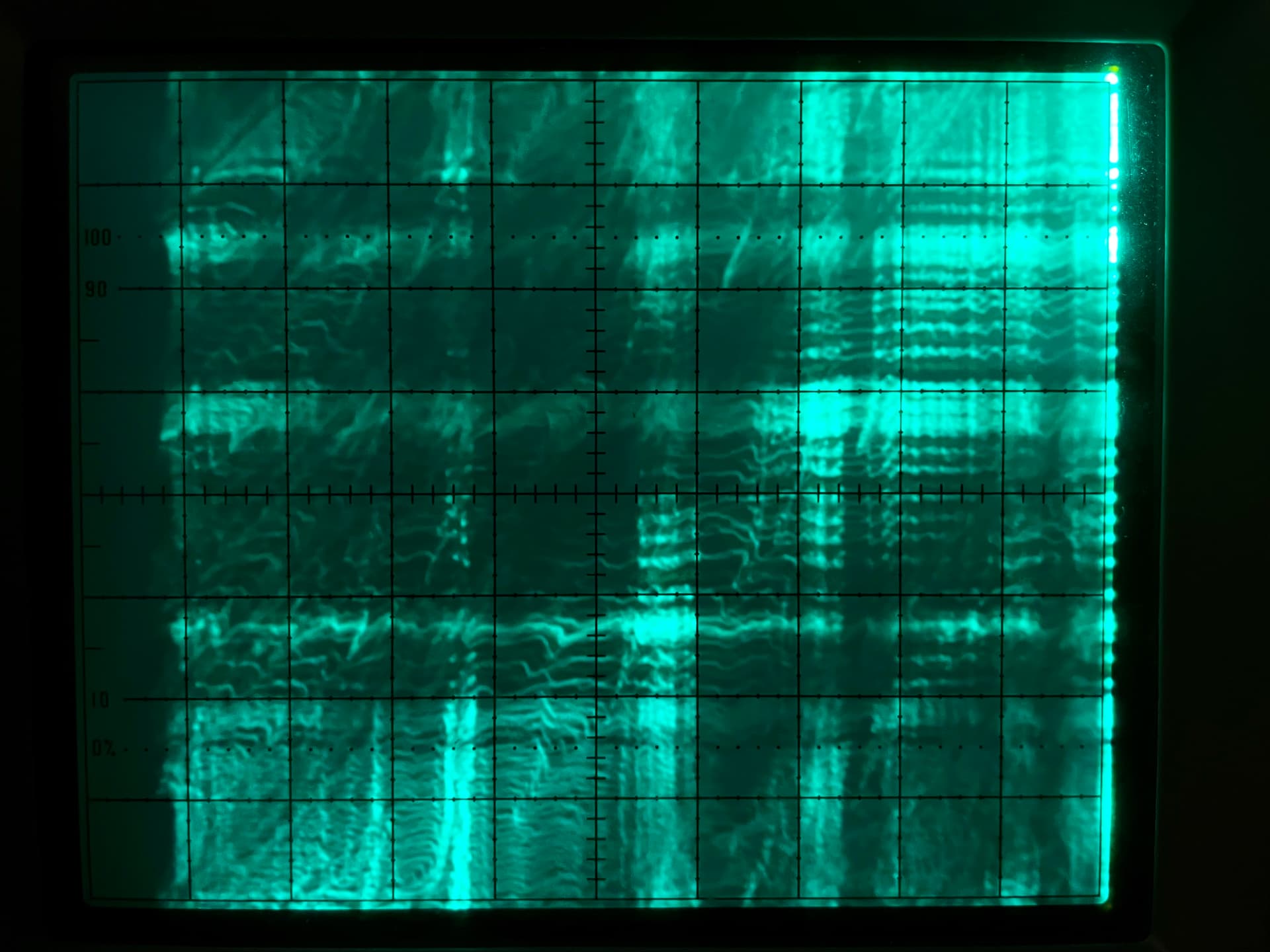

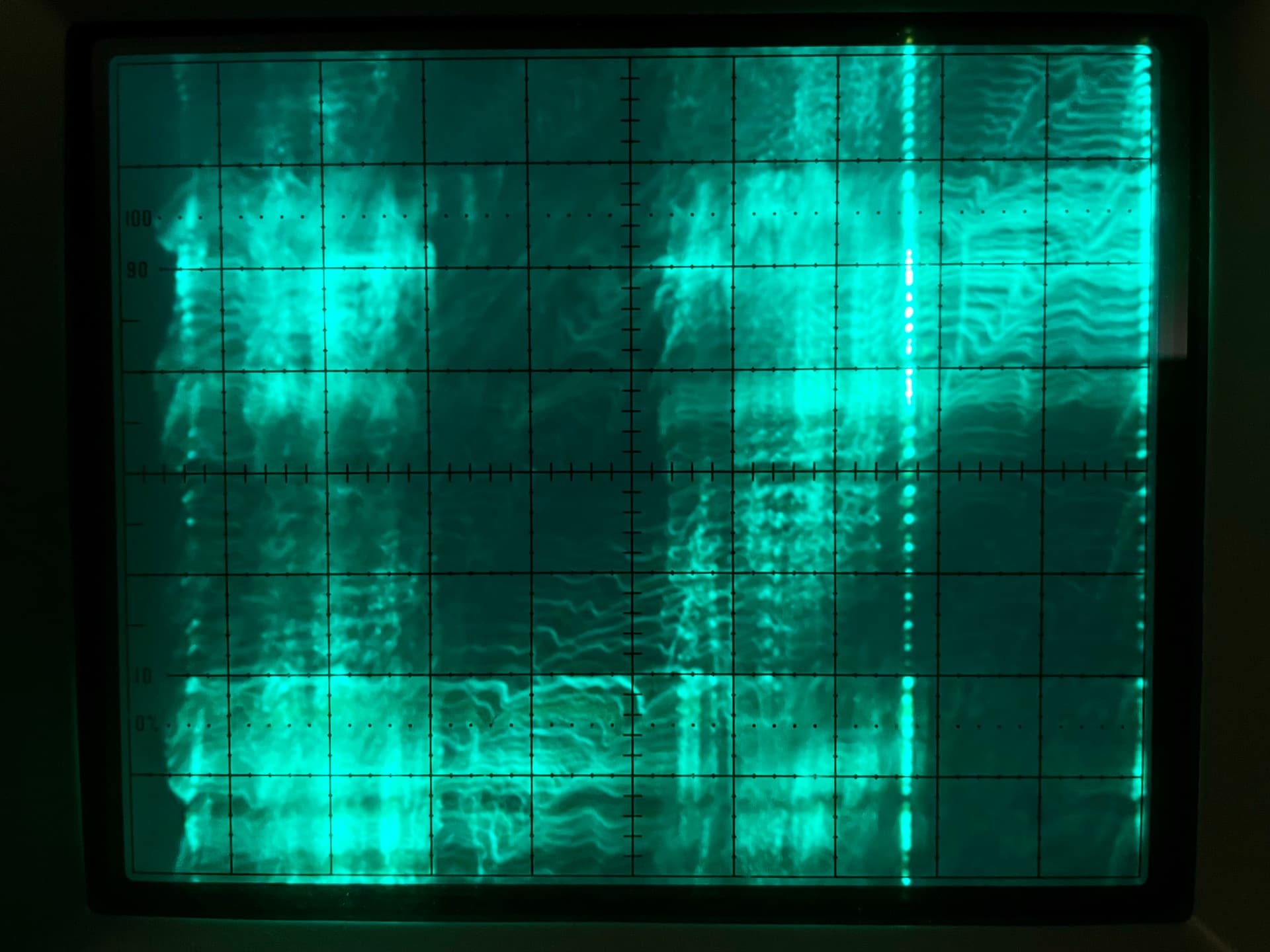

I tried to achieve a Rutt-Etra look, but with ‘only’ Diver. I took this patch as example, but used Diver instead of the VC and camera. And I didn’t use Navigator and Shapechanger.
Patch
Diver H+V into the oscilloscope X and Y.
Make a pattern with Diver H+V, H-V, Clock VCO, Arch and Staircase. Use the pattern as Z input for the oscilloscope, but also feed it back into the Wave input on Diver.
Result
It’s pretty chaotic but there is a nice sense of depth. Not sure if this officially qualifies as the look but I think it’s a great result for this minimal setup :slight_smile:
