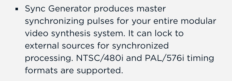

See I’ve been looking into all the sync distribution options and I feel like having to use up hp for it is not ideal. Especially with so many new projects lined up, I’d like to leave as much space open as possible. The reason I think Visual Cortex would work in this instance is this mention of accepting sync in product descriptions on a couple websites.

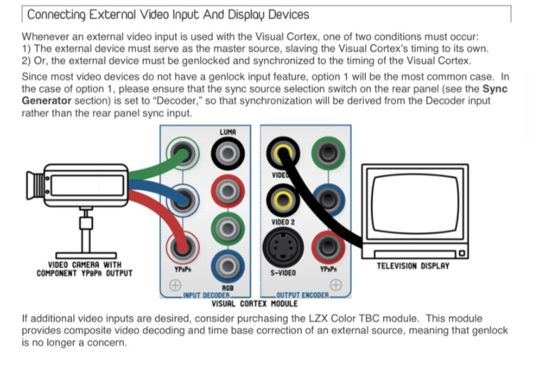

Edit: So I read through the Visual Cortex documentation, and it looks like this would be a totally valid method of synchronizing between two racks. If TBC2 front panel sync out is linked to the Visual Cortex via the decoder, it should sync the two systems together.

On the other hand, I do wonder if it mightn’t just be easier to use one of the Cortex composite outputs to sync TBC2? As no one (but LZX) has one in their hands yet, hard to tell how much advantage there is to using TBC2 as master sync gen over Cortex.
I suppose it will just be up to testing when the modules are in our hands. Though reading the documentation makes me feel very likely that this will be a perfect way to distribute sync through two cases with TBC2 as master sync.
