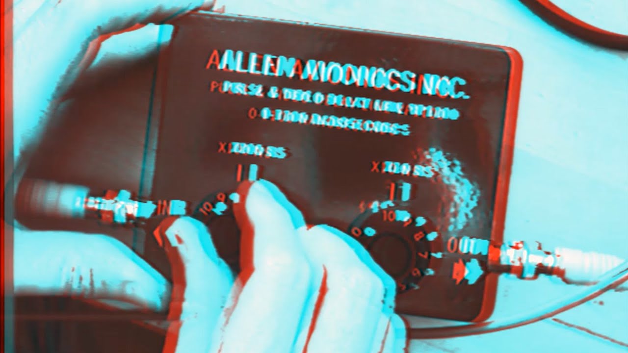

You can do some basic color channel shifting by putting a delay line in the signal path. Here’s a test I did:
That was just a test with splitting a b&w signal. But you could theoretically run one channel of a component signal into the delay before decoding for this effect on a full-color image.
But those delay line boxes can be a bit pricey once they get up to meaningful delay times (I happened to find one on Ebay at a halfway reasonable price). Definitely cheaper than 3 MemPals though! Albeit far less control.
