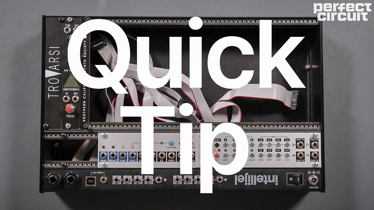

Heres a fix. :stuck_out_tongue:
Nice! I’m going to try this. Thanks!

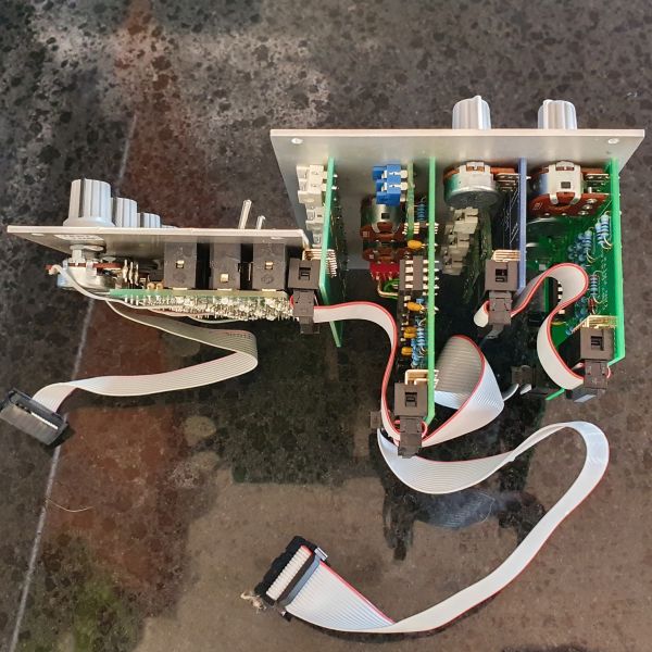

Just had a couple of modules arrive, for my video case being built in 2x Rackbrute 6U…
sure, the Rackbrute can fit the Cadets, but I wasn’t expecting this!
it’s an Elby ChaQuo, 85mm deep :dizzy_face:
following the above advice, I jumped straight on to ebay and bought 10x M3 Standoff 15mm. It’ll be ugly, but it’ll work. Will share pics when it’s fitted.
