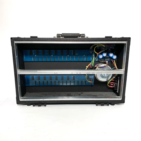

Early Monorockets had linear supplies, yes, like this one:
monorocket
But Kent is talking about a switchmode version, which I would approach with caution for video use.
