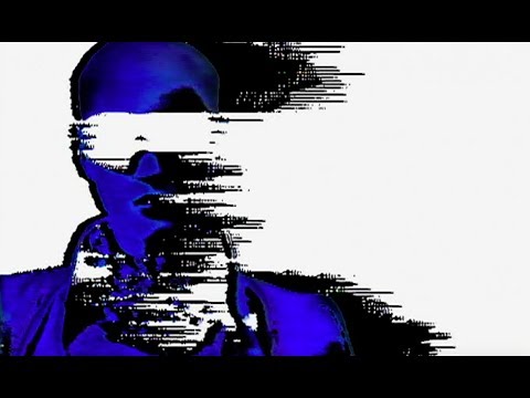

And if you’re into the glitch/deconstruction aesthetic, you might want to also look at adding some standalone glitch hardware with CV inputs like the Tachyons+ Vortex Decoder. Nothing in Eurorack currently does this stuff (but it sounds like that’s going to change in the near future.)
Tachyons+

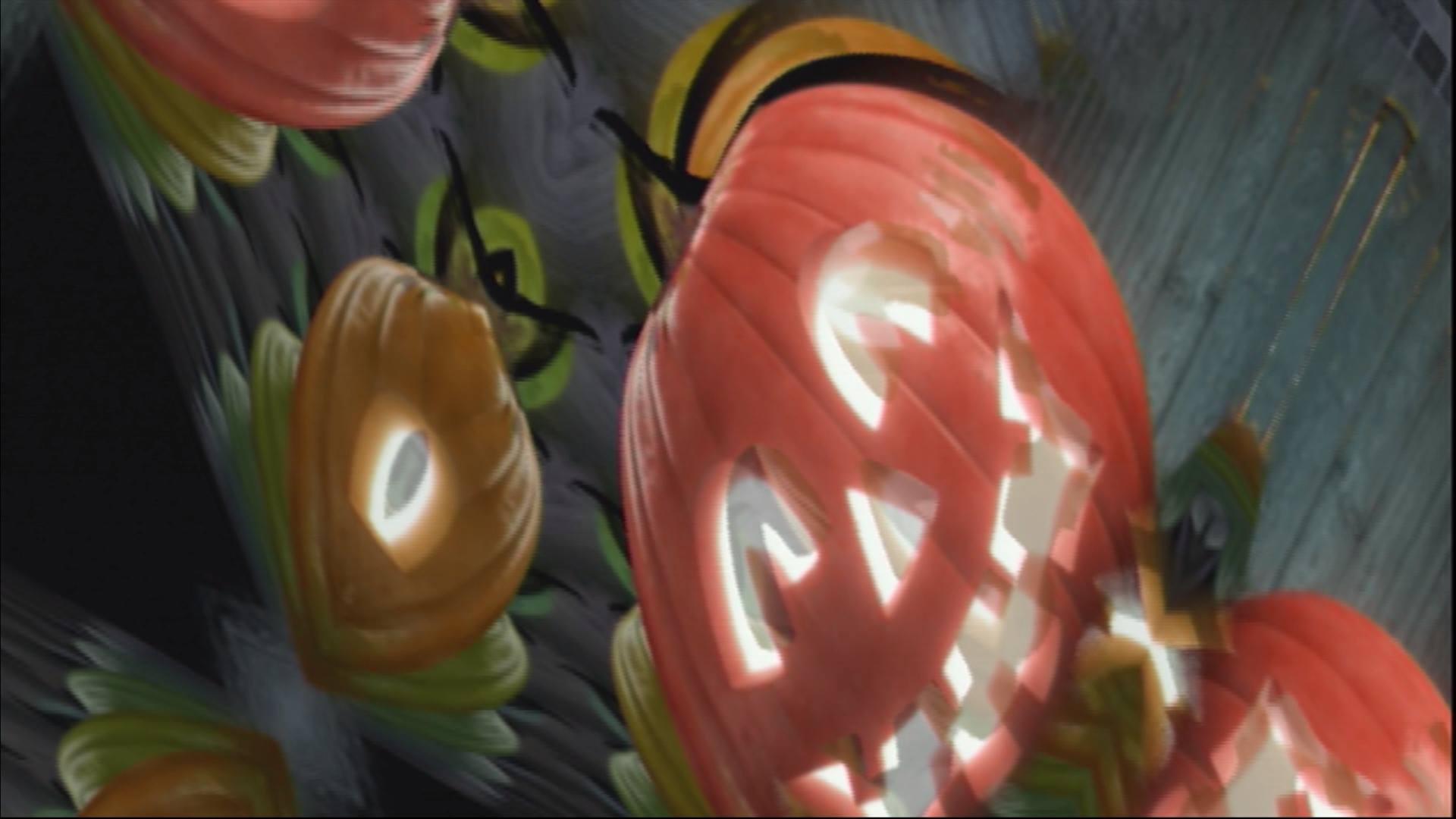

I was going to have a bit of a wiggle anyway so - Here are some quick demos I made of the modules I have - not one at a time per se… it’s more additive and very heavily patched - but it might give you some ideas…
source video is a short road trip video from last Christmas in Norway
I’ll try to do some more basic videos - just VC and bridge, just VC and Prismatic Ray soon and will add in Staircase when I pick it up on Saturday
video was played in praxis_live and then sent through lumen (camera pass through) to get it out of the computer and into VC
Modules were re-patched to some extent and wiggled live

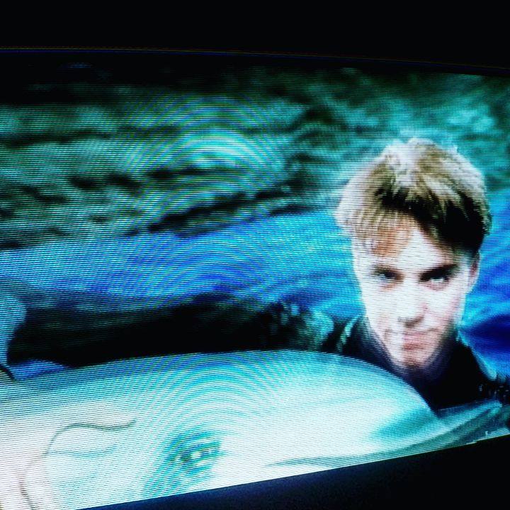

https://www.instagram.com/p/BnZm9Pigsuu/
Thanks, this is a big help, these demos give me a good approximate sense of what’s worth doing to a moving movie-style image. I should say that I really prefer to stay within Eurorack, as I already have cases and skiffs to keep things portable and the workspace compact. I’m hoping the Andor would be my only external unit.
