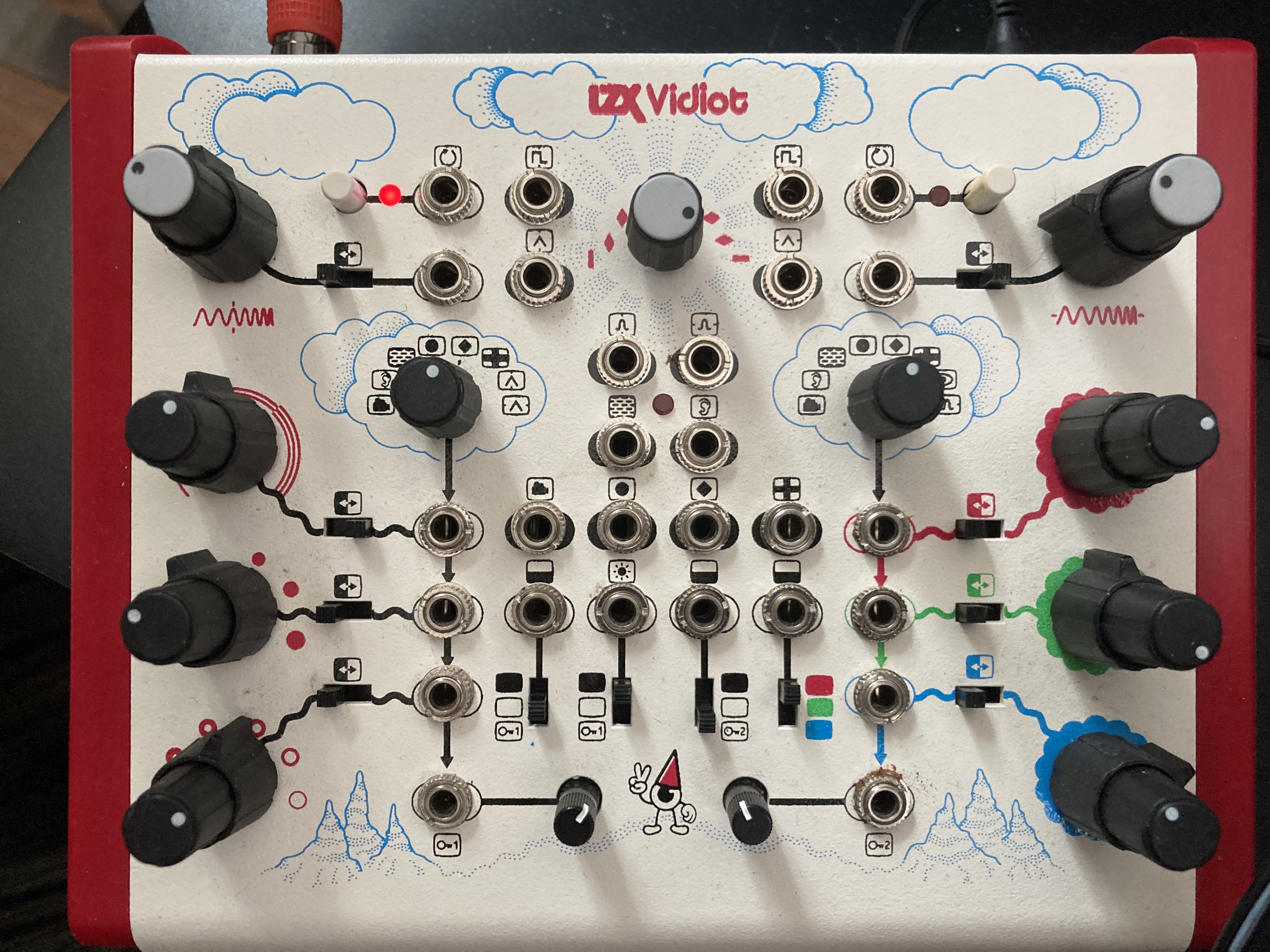

Here is a pic of the patch:
Here is a video of that patch the only thing I screw around with is the right oscillator to get different speeds of scrolling.
Jason at LZX HQ thinks it can be improved. Send a message to support@lzxindustries.net if you would like to send it in.
