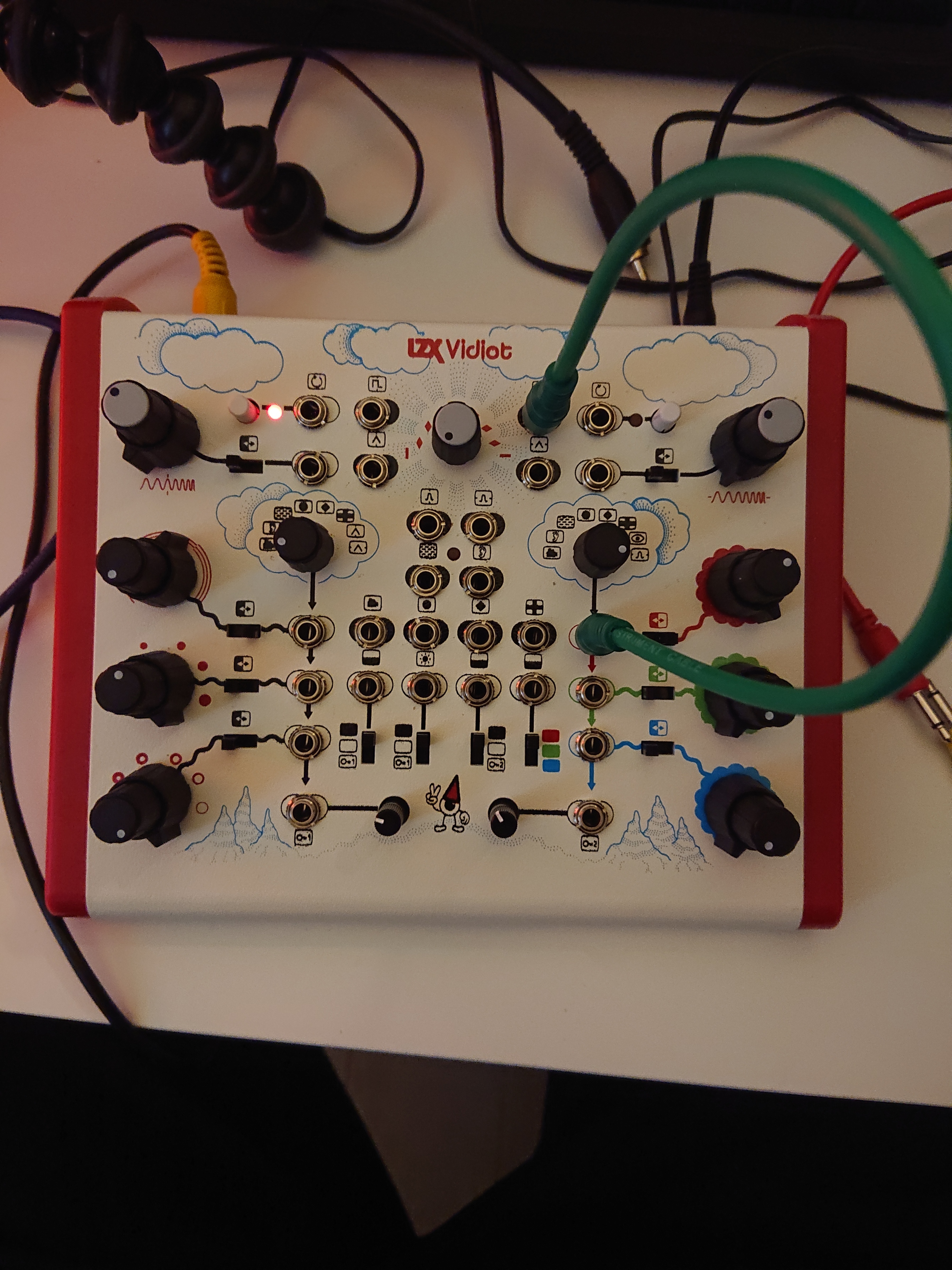

When I use the right oscillator for scrolling animation, it can become pretty wobbly at slow speeds.
I’m still getting to know the vidiot, so I’m wondering if this is normal behavior or not?
example:
(edit: it seems to be connected to what speed the left oscillator is set to, even though I’m not using that oscillator for anything)
Seems like an odd issue – occasionally wobbly drifting speed is normal, but the little jumps you’re seeing here aren’t something I’d expect. Is this with nothing patched?
Here is a picture I took of the patch used when recording the video above:
