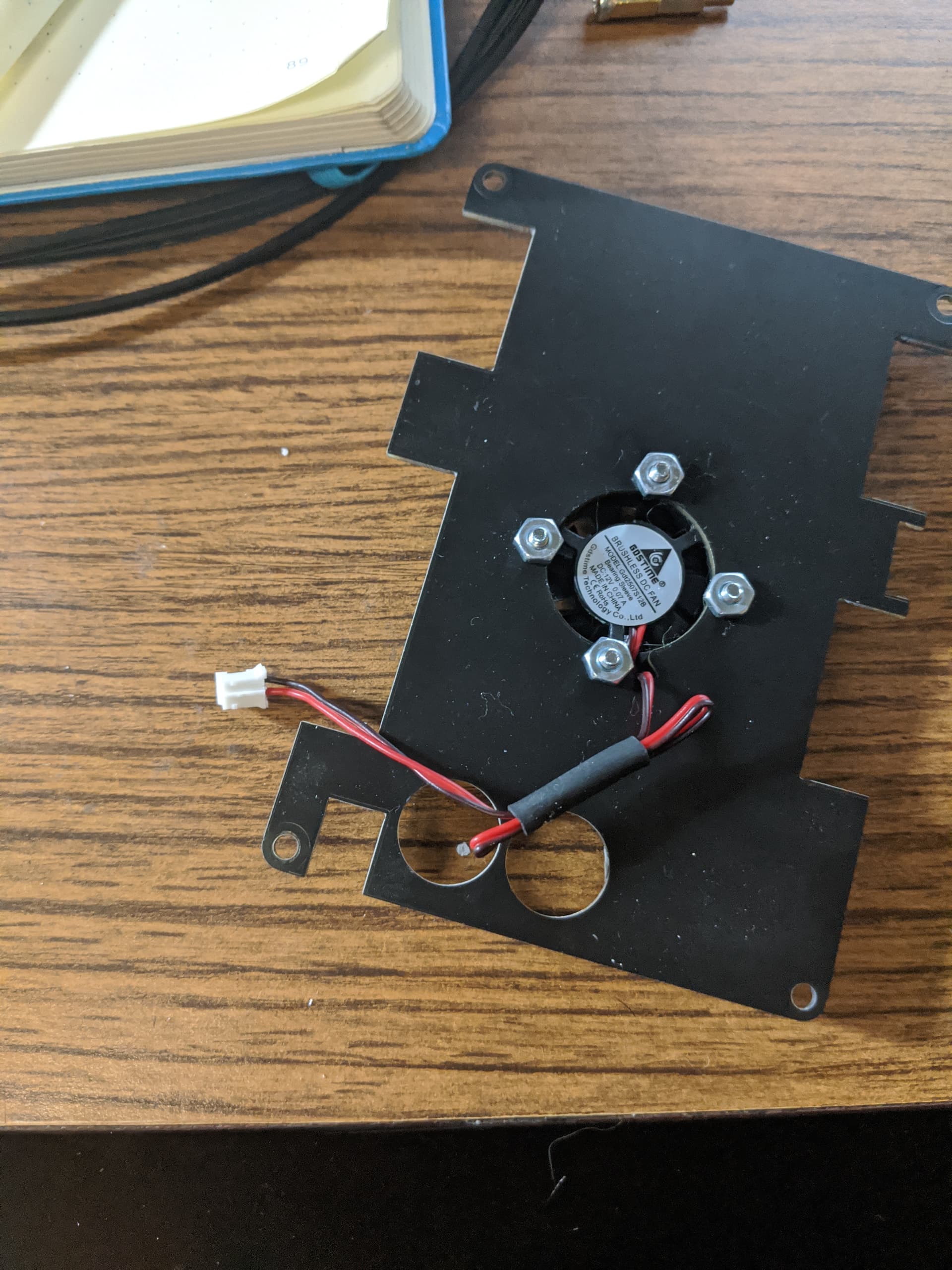

The TBC2 fan is on a standard 2-pin connector/socket, and mounted on the rear panel. So it’s easily serviceable if you ever need to replace it.

The good news is you don’t have to wait on cryptids like user rempsem to figure it out! The model/make number of the fan is right in Lars’ photo so you can search for a datasheet which will tell you what’s required to fit a replacement.
Just make sure the mechanical and power requirements are the same and that it meets your noise rating expectations and it’ll be a snap to replace!

It is a 25mm x 25mm 12V fan with a standard 2-pin connector. They are common as replacements on some 3D printers and graphics cards, so should not be hard to find. Here is an example from Amazon.
And if brand name/specs are important, here is a list of compatible parts at Mouser:
https://www.mouser.com/c/thermal-management/fans-blowers/fans/dc-fans/?q=25mm%20fan&height=25%20mm&noise=4.8%20dBA|~14.1%20dBA~~16%20dBA&operating%20supply%20voltage=12%20VDC&width=25%20mm&rp=thermal-management%2Ffans-blowers%2Ffans%2Fdc-fans|~Noise&sort=noise
The only issue with most of the above options is most are not going to have a 2-pin connector crimped on them, just bare leads. So you’d need to splice something like this onto the wires:

This Sunon MF25101V2-1000U-A99 runs @ 9600RPM instead of 11k for the stock TBC2 fan GDT2507S12B & rates at 16dbA vs the 25±10%dBA of the stock TBC2 fan.
The Sunon is rated at the same CFM & remember decibels are logarithmic so 6dB is alot
Bet the Sunon will put it into quiet territory. I can throw one in on my next parts order & guinea pig, it is too loud.
If that doesn’t do it I’ma just drill holes & install a bigger fan that’s lower RPM
