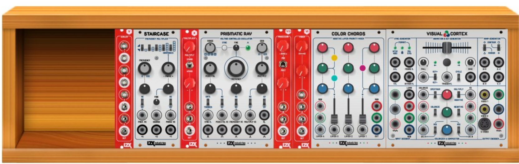

I’m currently borrowing a friend’s Vidiot and having a blast. I already have a full Eurorack system, and am plenty comfortable doing DIY. Since I want to ventually expand to a system like this, I’m leaning towards a Visual Cortex over vidiot. I think I will start with a system like this (maybe with a doorway, shapechanger or navigator in the unfilled area)
Since I’m really loving the Vidiot though, I was curious about getting some more feedback on where to start, as there are some things it immediately gives you which you don’t get with a Visual Cortex…
I love the immediacy of the Vidiot’s two oscillators, but I think getting a prismatic ray, staircase (or 2?), and building a Cadet scaler to go with the Visual Cortex would probably be enough to have the oscillator/pattern generation aspects mostly covered. Would love to get the cadet VCO but it would be too big for my current skiff (only 50mm/61.3mm). Creating the default patterns from Vidiot seems relatively straightforward w/ the right utilities and two oscillators. Maybe lose some potential by only having one oscillator that is capable of being FM’ed at video-rate, but that doesn’t seem like a terrible thing!
One thing I love about Vidiot so far is patching the RGB outputs back to various inputs - but I believe this could be achieved with VC by patching the YPbPr outputs to the YPbPr inputs (though this prevents camera usage… unfortunately). Can someone verify that this would be what I expect?
Another thing I love about the Vidiot is CV over colorization (e.g. using LFOs from modular to control colorization). I believe with clever patching of the compositor section this would be easily achievable: For instance, in multiply mode, you could patch your pattern into colorize, turn MIX for channel A on, and then use channel B for your slow color modulations. (maybe dummy-cable composite to keep the composite VC at 0). Alternatively using 3x Cadet Multipliers could do the same thing.
I also really like the Gate/key inputs for solarize/negative/color+rgb negative on Vidiot, but I think you could also get lots of related results by creative patching of the compositor and/or Cadet/utility modules. It seems like you could really get some unique things by how you decide to patch signals to colourize and/or composite, how you set the mix+composite mode switches, etc. Getting color chords now (instead of e.g. shapeshifter or navigator) seems like it would make a lot more crazy stuff possible with the compositor on VC
Obviously with Vidiot you get 2 keys, but with the Cortex you can automate threshold changes which seems incredibly useful to me based off of how much fun I’m having playing with the Vidiot thresholds.
VC also doesn’t have all the useful attenuators/inverter switches, but that doesn’t seem like a huge deal.
Anyways I know this is a lot, but if anyone has any more thoughts on this, I would certainly appreciate hearing them!
You may want to look at Marble Index too. It can do a lot of the things it sounds like you’re interested in.
