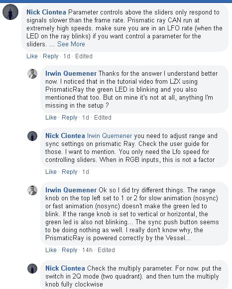

I don’t have time to transcribe this post from FB which answers some of your questions, but I hope you can access it and get the information you need:
Do any of those suggestions help?

I’m still not able to have the green light blinking. I’m using some RCA cable (the yellow one) which are maybe not good enough. I haven’t bought the one from LZX so the sync is apparently not working. Are the needed RCA for sync specific ?
PS. It’s me on facebook as well. I posted on both, sorry for duplicate. His suggestion doesn’t make it here also…
