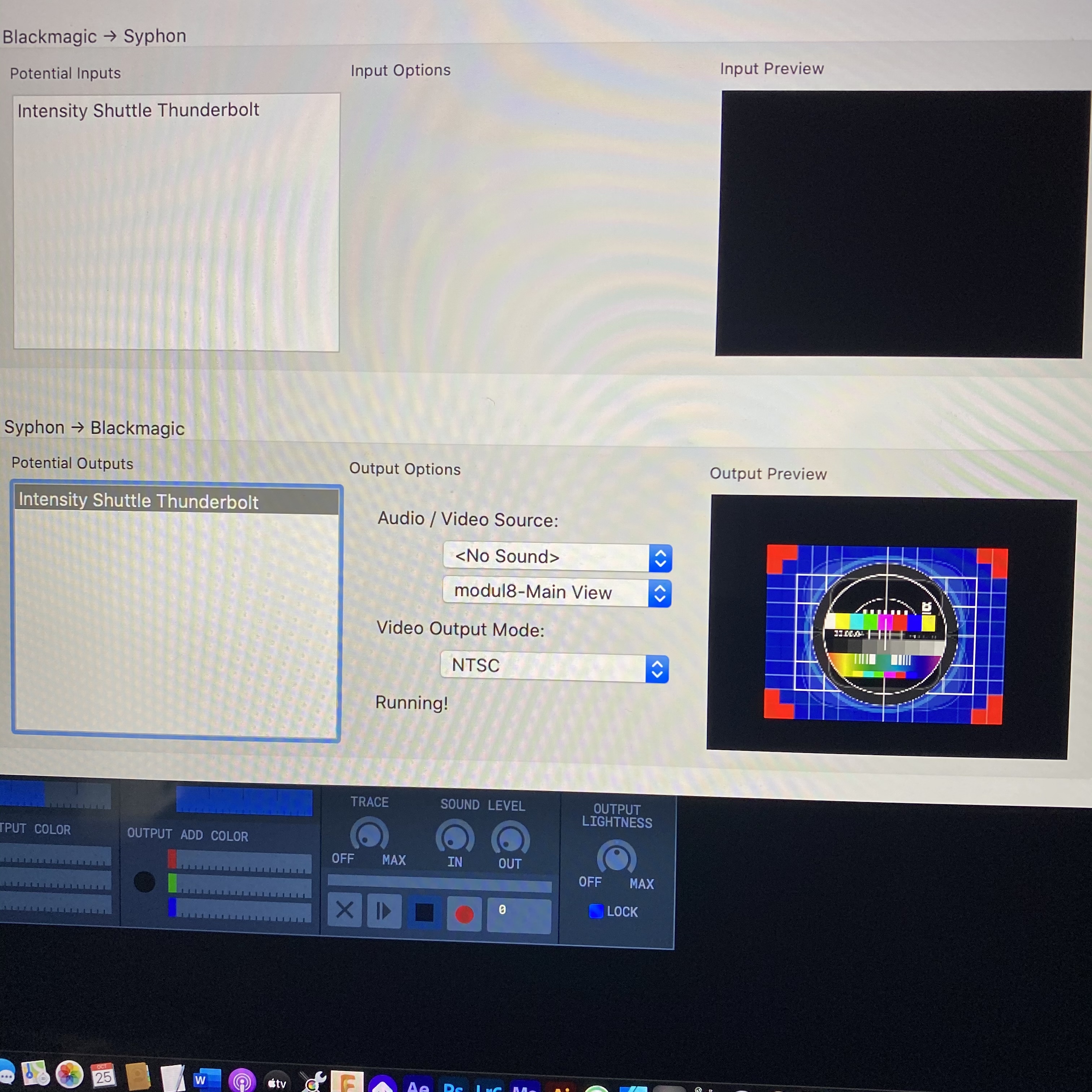

I can capture the vidiot fine, the card is working, but it does not show up as an extension of the desktop in the displays so normally when I ‘output’ from modul8 or mapper, I just go fullscreen (to either hdmi tv or projector) but in this instance I assume I need to port the signal? And have downloded black syphon to do that.

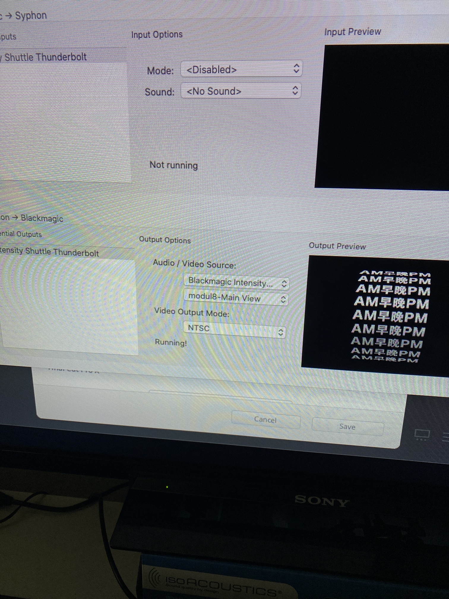

It appears to be running okay to syphon, but still getting black output to a montor (wanted to make sure I could see the signal before running to vidiot)
I have tried all the NTSC options as output, and cant seem to get it cracking. If anyone has a success on integrating this (mac) setup please walk me through it.

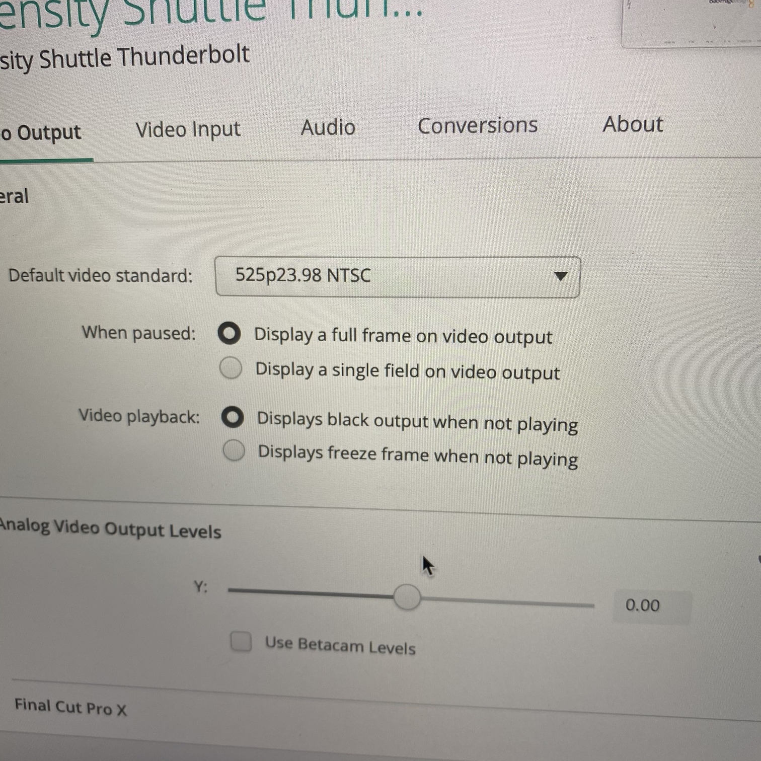

I think that video output standard should be set to 525i59.94 NTSC (I see you’ve said you’ve tried them all, but…)

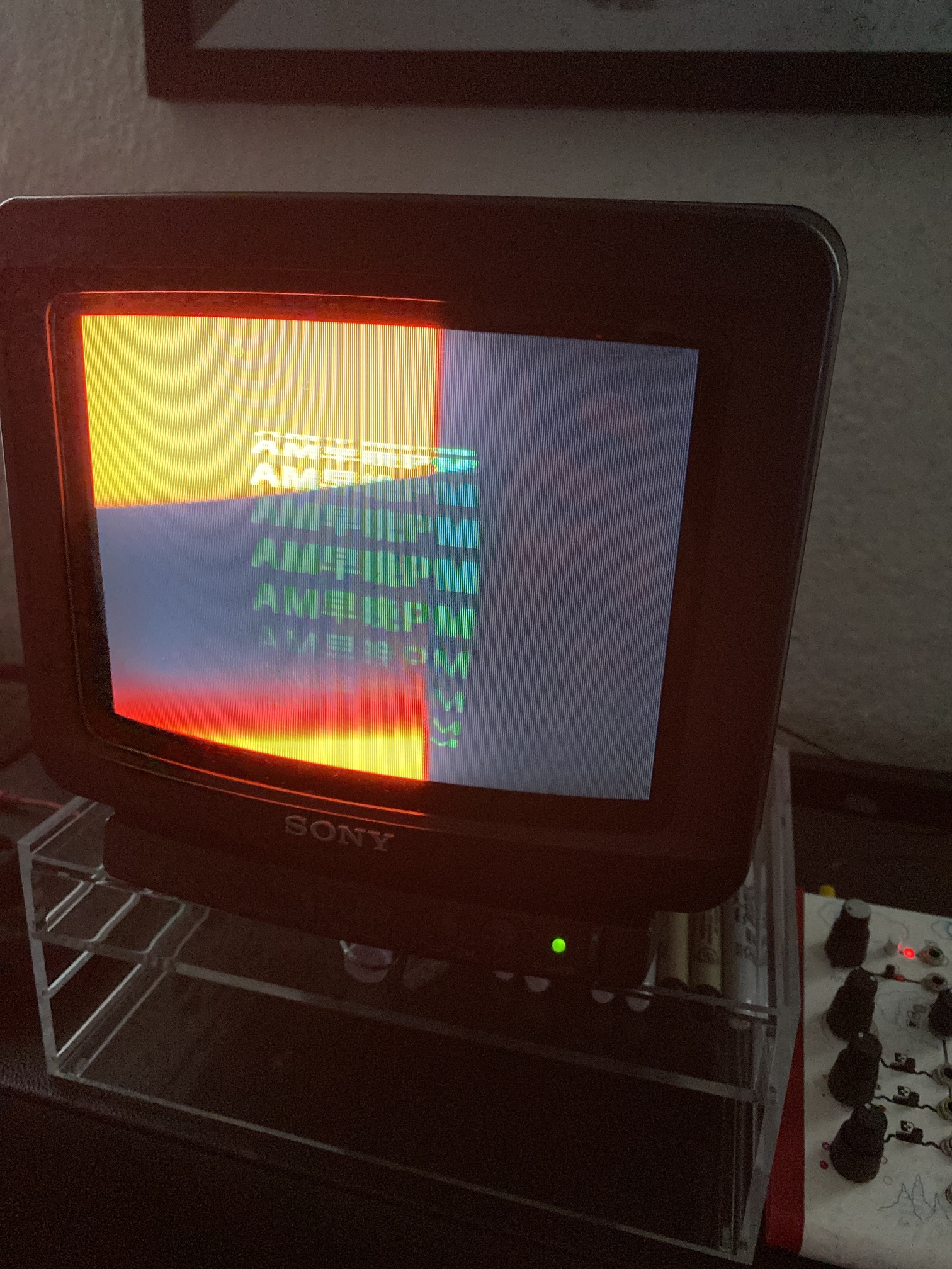

Output format worked! Thank you. Has a bit or problem with the scaling but at least it is piping though to both ! For those that experience this issue : here are my settings for syphon to make it work, the one thing that might have been adding an issue was not having microphone access outputting in real time so :
Great!
For the scaling issue, is it an aspect ratio issue? While I don’t use Modul8, I do use a similar program, Coge VJ, to play to an Intensity Shuttle and then to an LZX system. And the output settings of Coge need to be in a 4:3 aspect ratio to properly display. Presumably same would be the case for Modul8.
Yep, changing the output scaling in syphon worked (1280x960), you can adjust the syphon / ndinoutput size, on the prefs tab in Modul8 (for anyone that might have this issue down the road).
Looks pretty good now!
