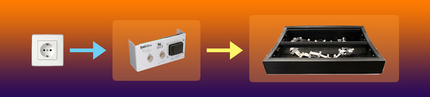

A simple representation of the system.
If youā€™re sending DC through this, then perhaps 4 pin XLR would work well. It canā€™t be confused with anything else and has more than adequate current capacity (10A per pin, use two for ground and one each for the +/-12V rails). Something like a Neutrik NC4FXX on the cable and NC4FD-LX in the case might do it.

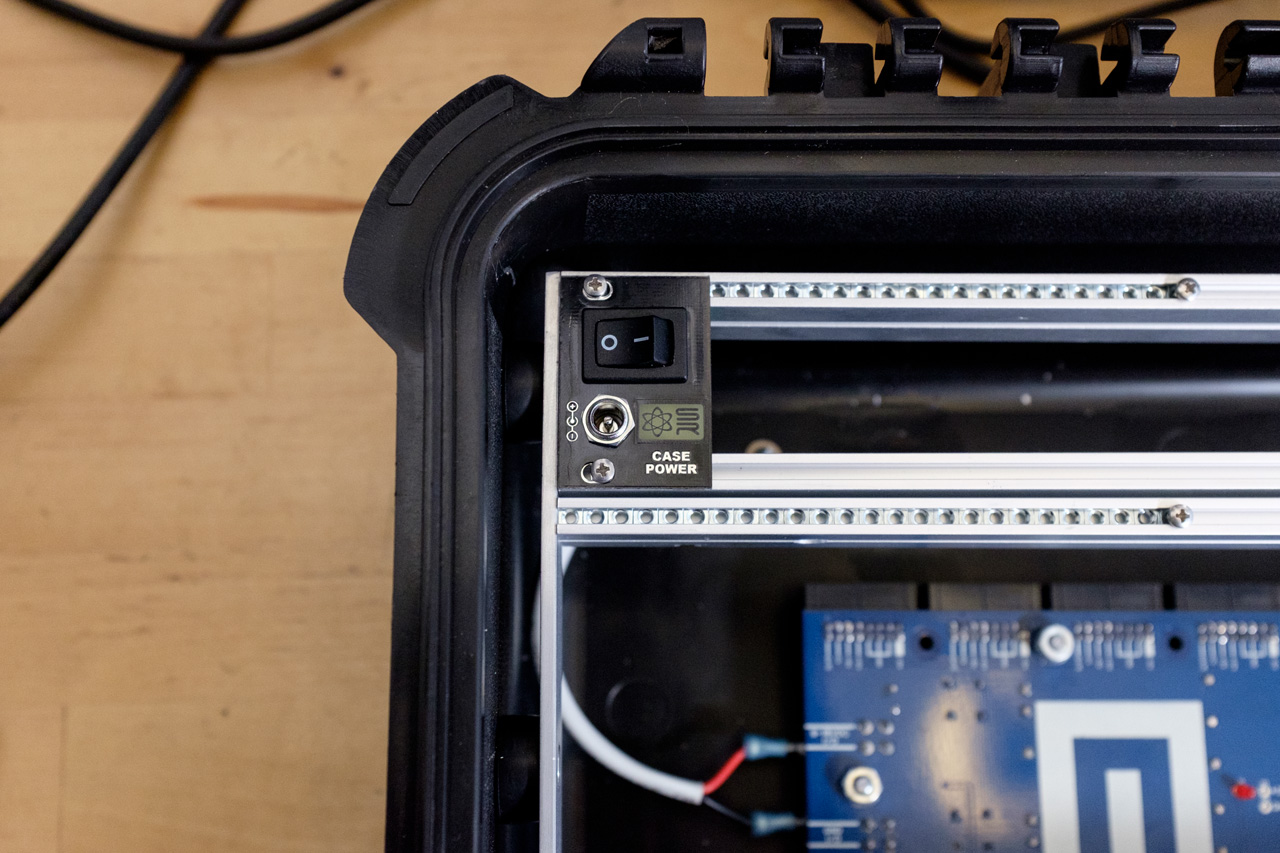

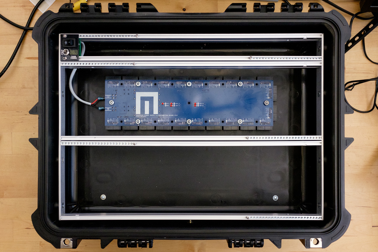

After collecting parts piecemeal for probably almost a year, finally put together a case today ā€” with a lot of help from a friend who is far more handy than I (my main contribution was slicing open my thumb while trying to shorten a screw).
Very close to what @Tan_Sat posted above, but with an extra 1u row as well. Used @Dewbā€™s drill template, so thanks for that!
Will post parts list below pics, in case that helps anyone.
Didnā€™t want to wait for the LZX power module, so just built this 1u Synthrotek power inlet kit:

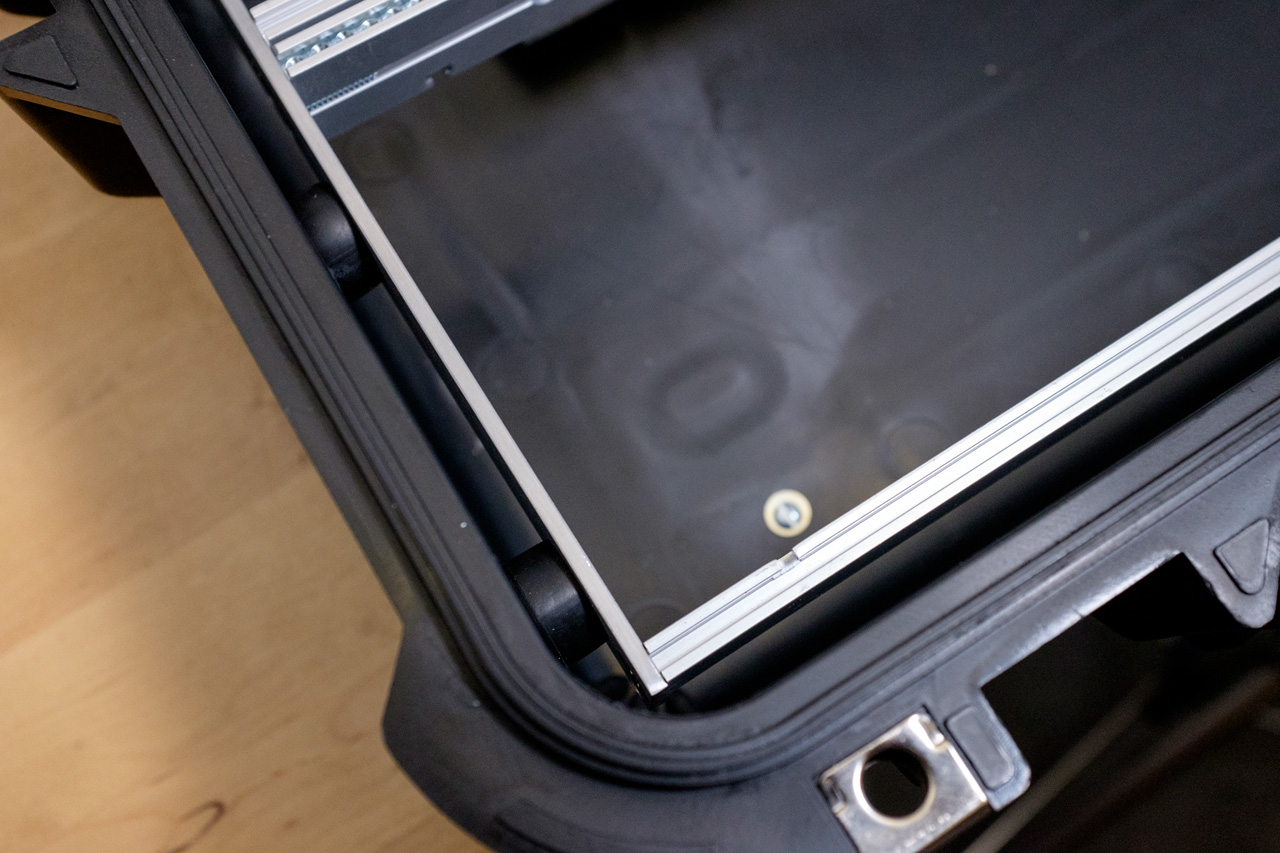

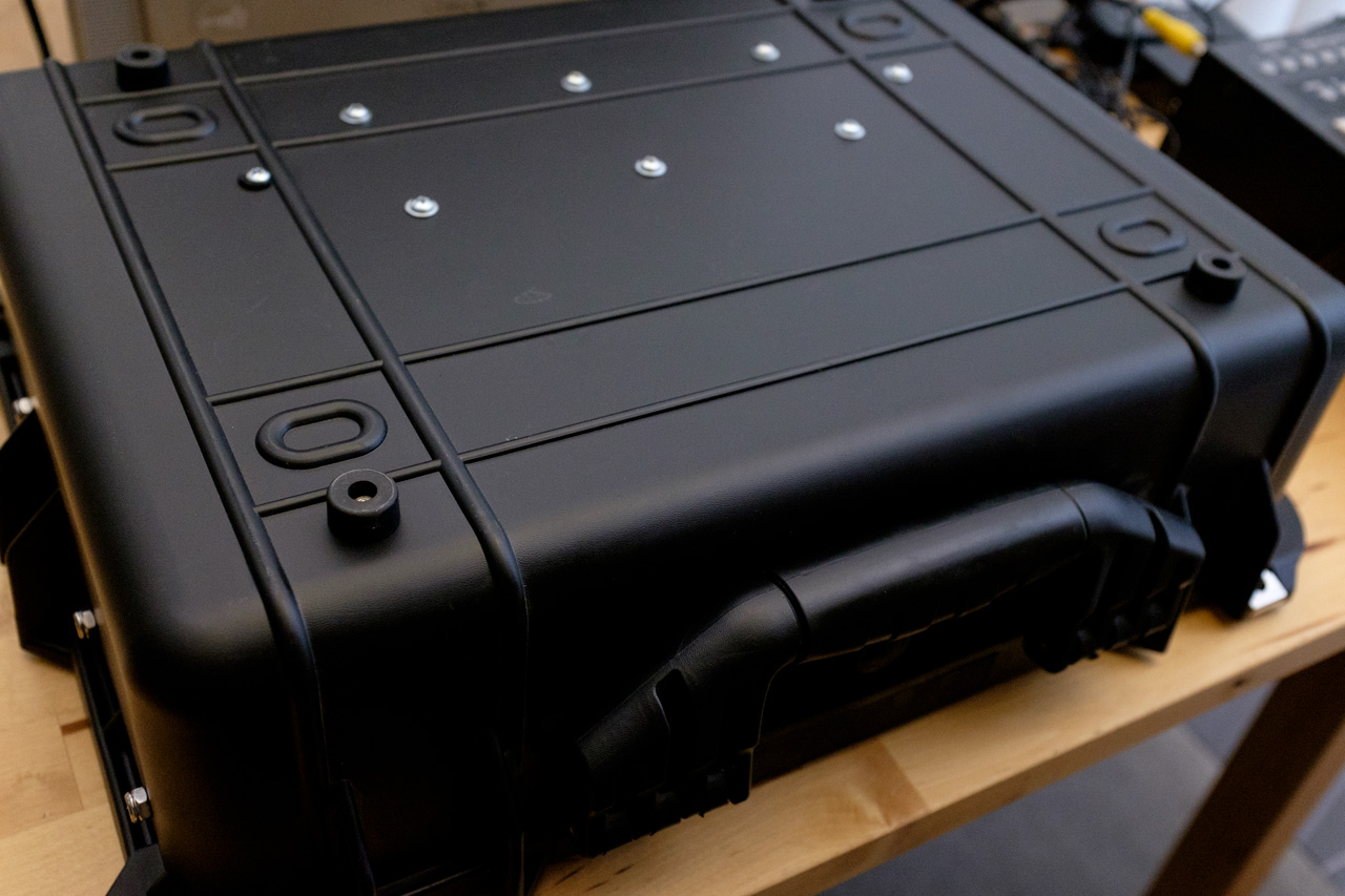

Added feet, so the screws on the bottom donā€™t scratch tables:
Ended up using the same exact feet for the spacers on either side of the rack bracket since they were a perfect fit:
Harbor Freight Apache 4800 XL Case $55
Malekko Power $229
Cincon TRH100A120 DC Power Brick $45
Synthrotek 1u Power Panel $18
Vector TS169 Rails x 6 $66
Pulp Logic 1u + 3u + 3u Case Bracket $40
M2.5 Square Nuts $12
& ~$10 misc. hardware
= $475
(not including taxes and shipping, but I also picked up several of those things on sale or used, so I estimate my total cost was more like $450)
