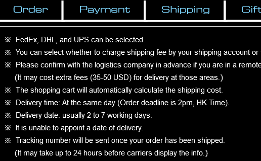

I have’t heard of them before. They’re Hong Kong based I think, basing that on the “same day” shipping option with a deadline of 2pm, HK time.
