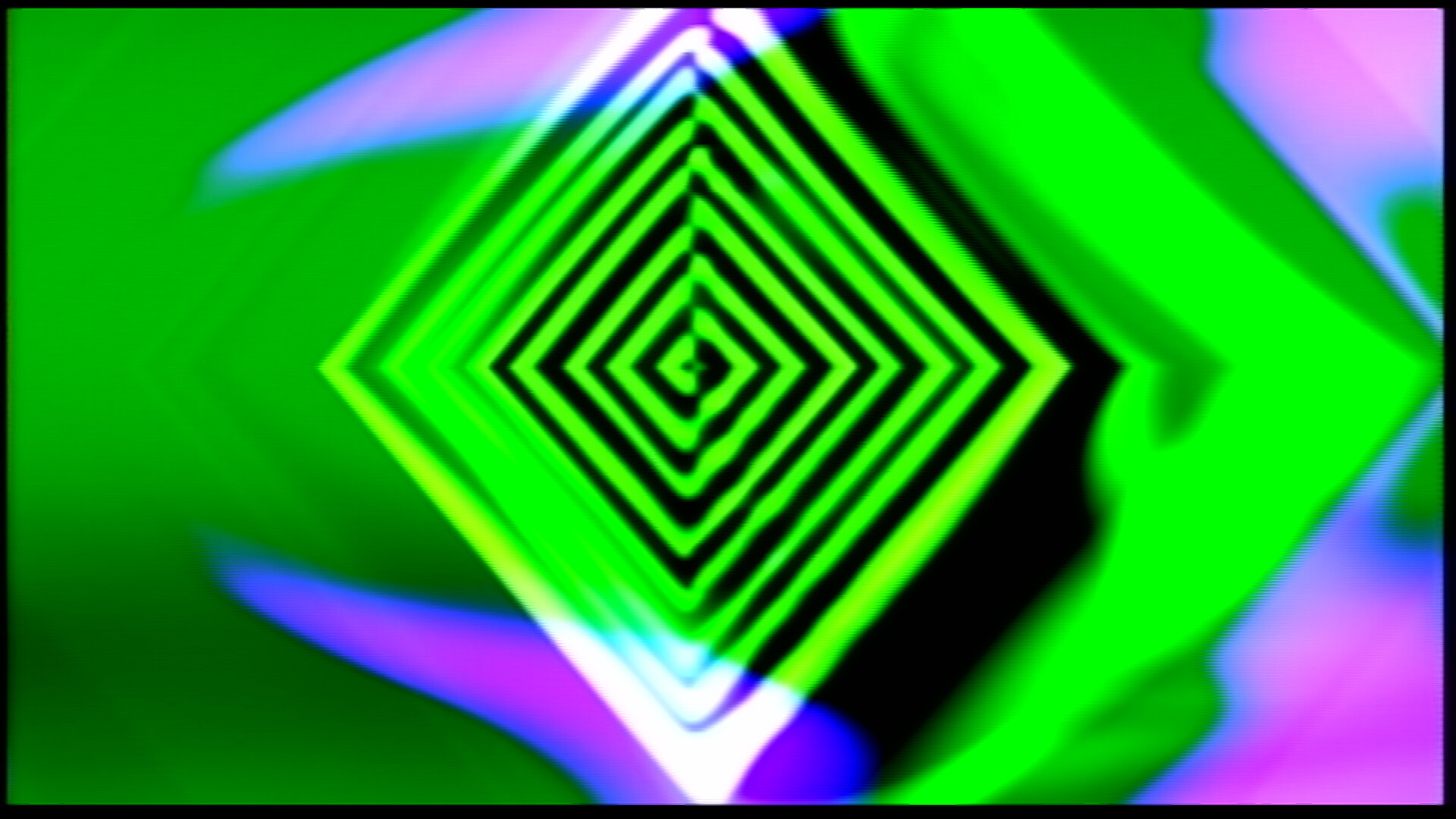

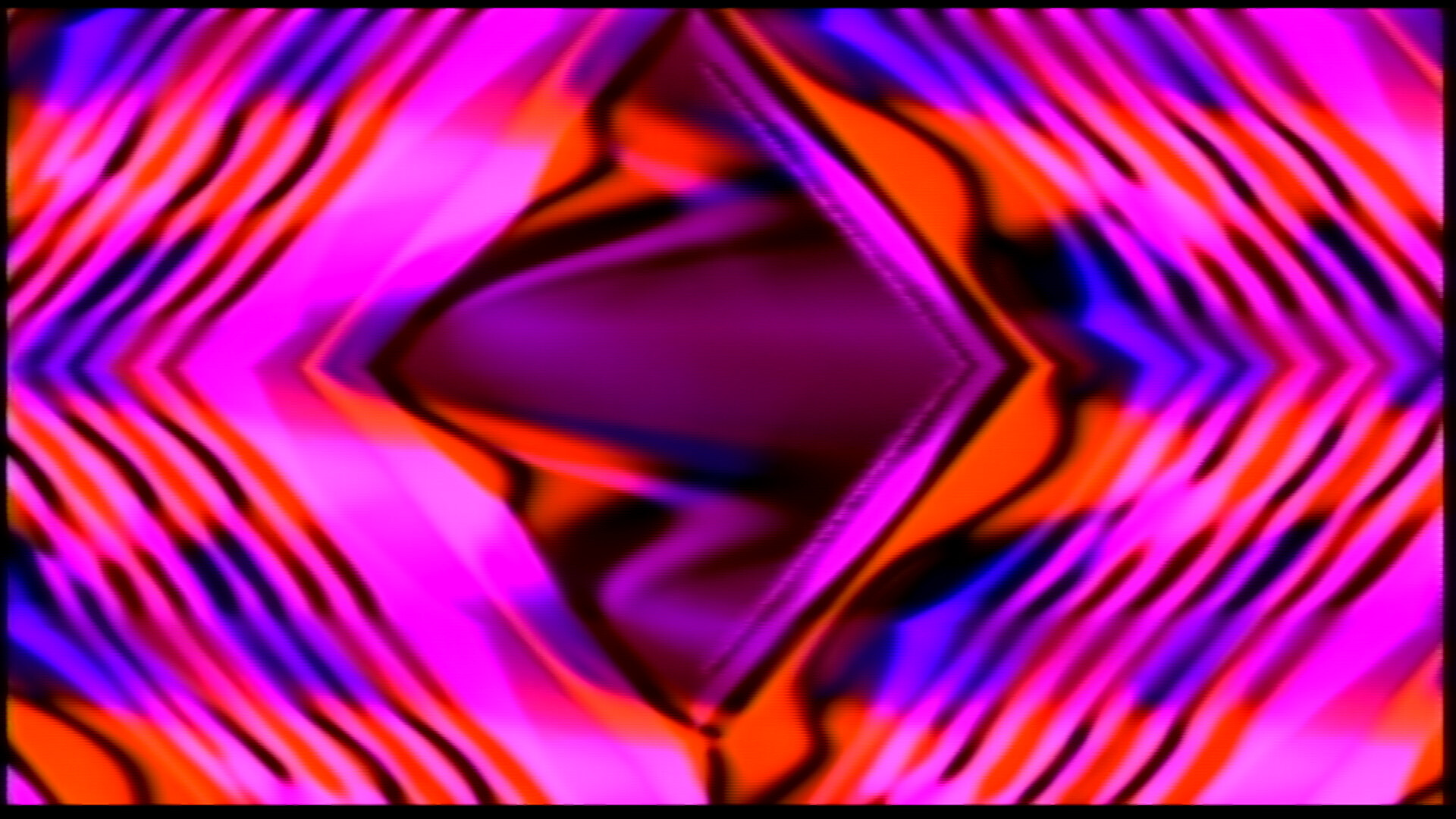

I do run a similar LZX Visionary Encoder->V4->UP(BM Analog to SDI into Decimator)->ATOMOS HD CAPTURE and feel very happy with the results. I haven’t noticed any drop off going into the V4 if that is what you are specifically asking. I also think the V4 is the best live performance SD mixer ever made, it is a video art tool all by itself and is essential for live visuals with an LZX/Feedback setup. I struggle to think that you wouldn’t find a use for it even if you use it in a different part of the chain than what you lay out above.
Included are a couple shots with the workflow I described above:
Hope this helps and if you find a working V4 under 250 you should buy it in a heartbeat :wink:
Yes, these captures look great (and are around what I would expect / have gotten from my upscale chain). I guess I am looking for a hard a/b of captures from upscaled SD mixer VS upscaled chain running into an HD mixer. I am positive they will look different, and of course ‘better’ is subjective, but if anyone has some hard tests, please feel free to chime in.
