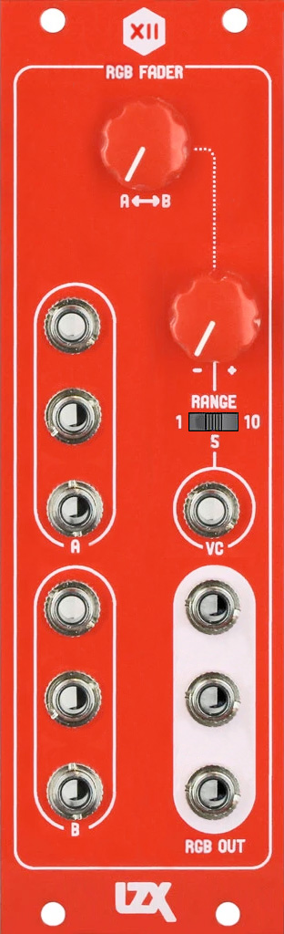

Here’s another one of my “wouldn’t this be nice?” Photoshop renders:
(Again, not taking into account the panel space vs. PCB space issue… This would certainly need to be a couple/few stacked PCBs.)
Added in a scaling switch on the CV input, figuring it could pair nicely with something like a Wobla.
I think @VisibleSignals is working on something like this:
Ah, yes. I had seen that, but forgot about it (I tend to be so visual that, if I don’t see something like a full panel sketch, it doesn’t quite register with me; hence the renders).
Nice!

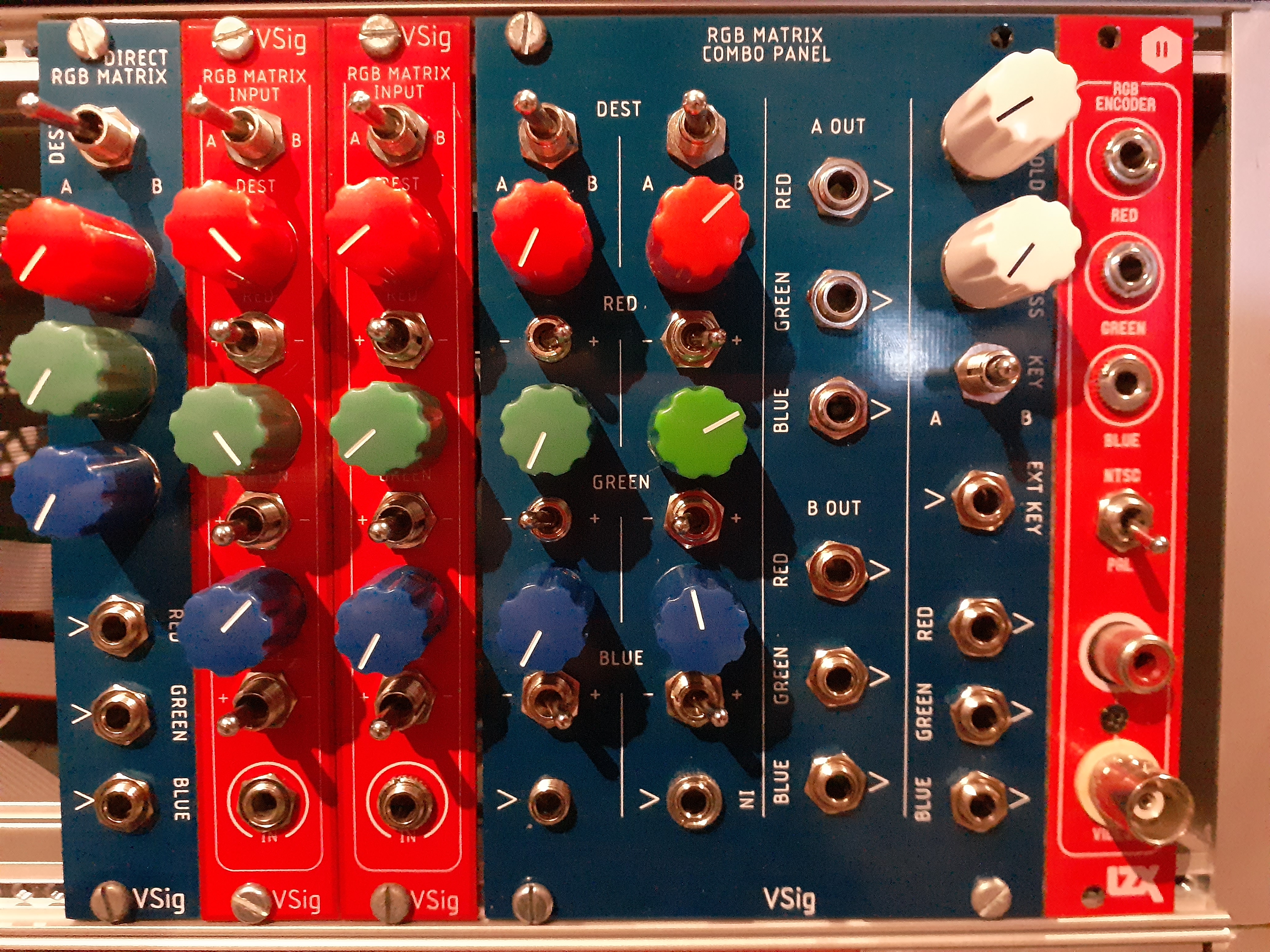

Here’s what my RGB Matrix modules look like (please ignore the red preliminary prototype design, the blues ones are what I’ll be offering). I’m sorry it isn’t announced properly yet, I’m just making some demo videos to show how it works and sorting out the final details to make them easier to assemble.
The Combo panel has two Input sections, an Output section and a Keyer section - I’ve since added text to the panel to indicate this.
Very cool @VisibleSignals. Looking forward to seeing the demos and getting a better handle on the signal flow.
What is the idea behind having a destination switch for A/B? Does it let you sum the A/B channel inputs together into a single RGB out, say channel A, and then channel B is 0V?
It has two RGB buses, and each input can be routed to either the A or B bus (or neither if the Dest switch is centered). The output module has separate RGB outputs for each bus. The keyer crossfades between the A and B bus, based on the luma of bus A or bus B, or an external CV, and has controls for manually adjusting threshold and sharpness of the crossfade.
One of my goals is to start replicating some of the functionality of old home video mixers in eurorack format.
