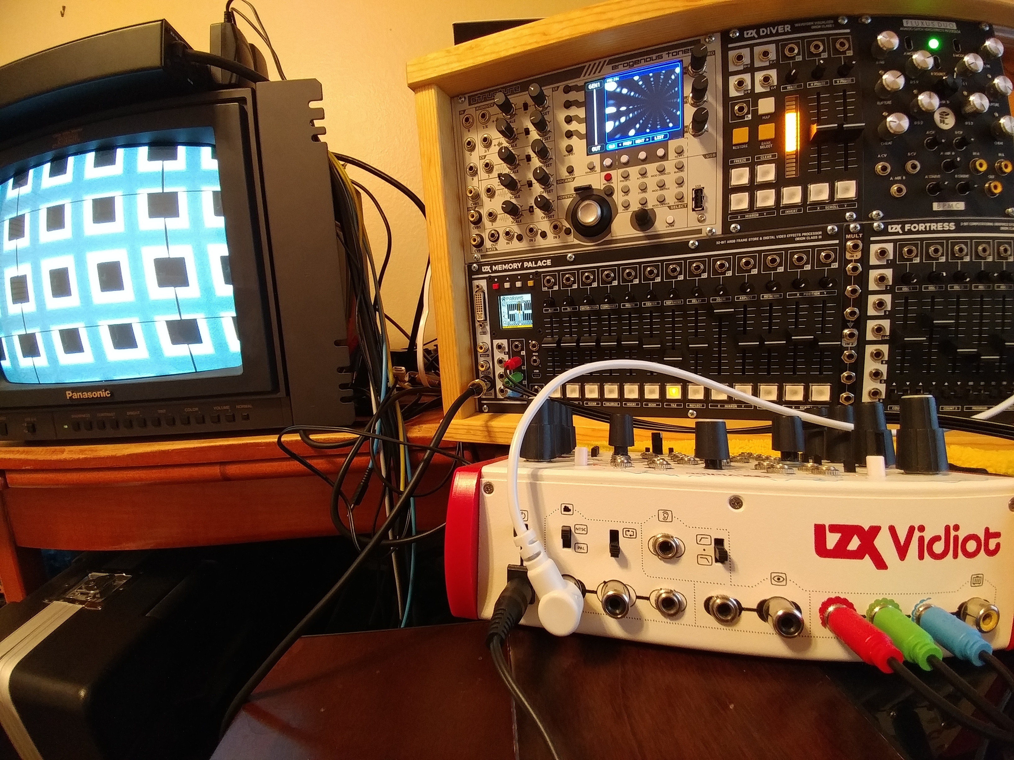

On a somewhat related note, is it possible to get rid of or adjust the borders around tiled image as seen in attached image?
Thank you!
Excellent. Glad you found the path!
Aside from the black & white issue, everything sounds normal–including the borders, which are an anomaly of the Vidiot/Memory Palace combo (and are a byproduct of Vidiot’s sync output).
