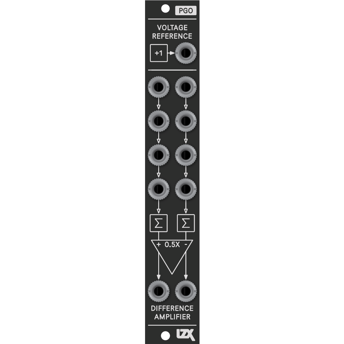

I vaguely remember something about Automata instruments, specifically a texture voice. That and a line of new DIY modules. Are there any vague plans in those areas still?
I don’t know about Automata instruments for future release, but I recall that being talked about in the past too.
As for DIY, this module is currently available in built and kit form and seems to be a solid step into the future of DIY modules:
Oops, I hadn’t read the latest blog post. So the P Series [like the PGO] is the foretold DIY successor to the Cadet series. That’s awesome news!
