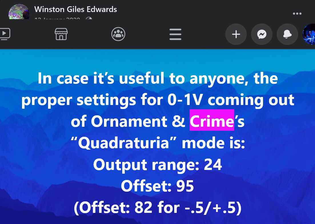

#O&C
Ornnament & Crime at 1V :slight_smile:
Your settings may vary.
It depends a bit on each unit and their calibration.
That said, setting o&c to 1v is fantastic, I used it a lot before having the syntonie lfos.
Having weird waveforms in audio range oscillators and feeding them to diver is a simple and nice patch.
