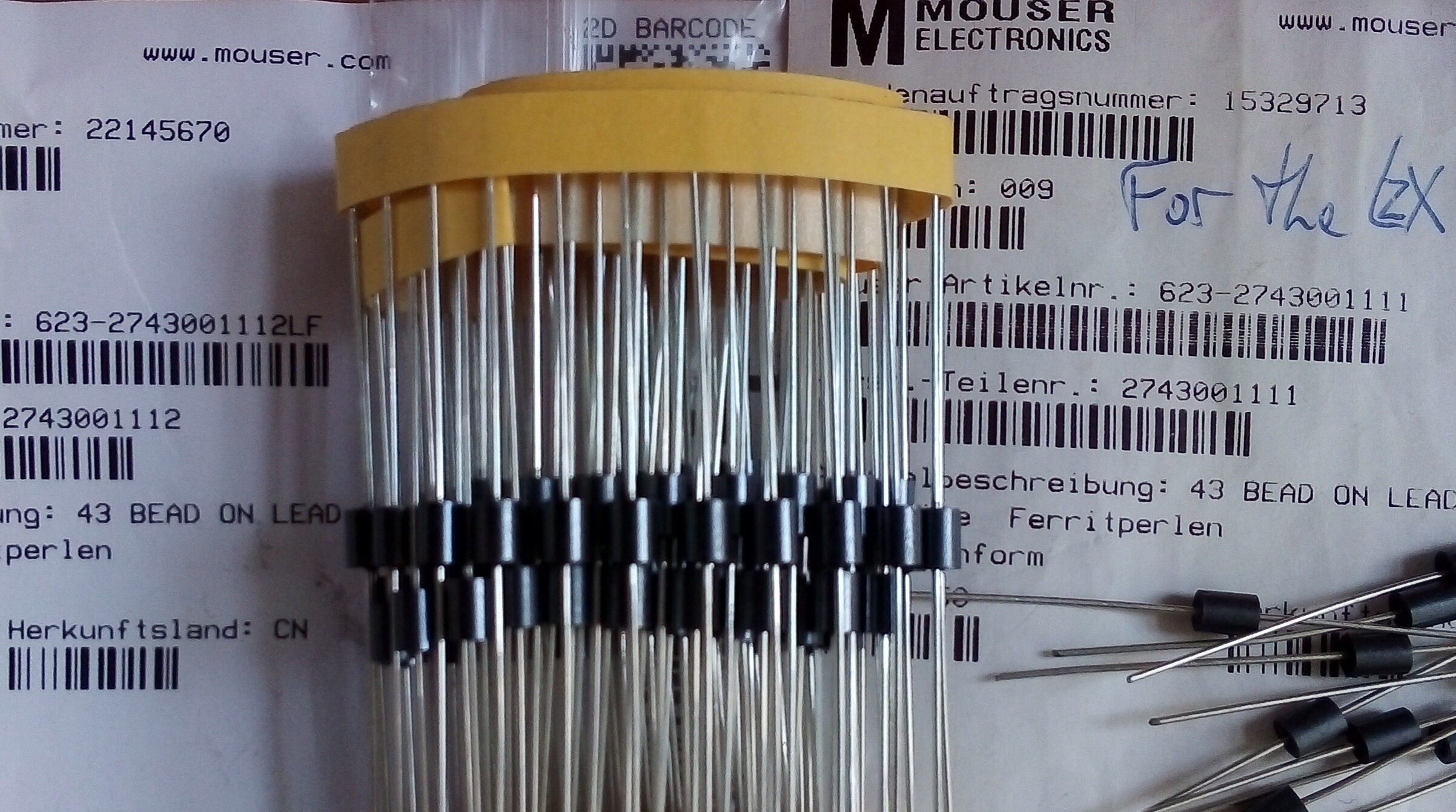

About a week ago I noticed that the standard ferrite beads (623-2743001111) in most, if not all, of the DIY video synth builds were out of stock on Mouser, the xpected delivery date is 15/09/2021. Thankfully I looked through the datasheet looking for exact info before searching for a suitable replacement & saw that there’s a 2nd identical version simply on tape & not loose, the 623-2743001112LF.
Of course there were thousands in stock & it didn’t get suggested as a suitable replacement by Mouser when I hit the “Show Similar” button under the product specs, there were 2500 recommendations ![]()
It might be a good idea for the various module designers like @VisibleSignals, @syntonie, @reverselandfill, @Fox, @pbalj (& anyone updating the Cadet BOMs) to add the part number to their upcoming BOMs or any that needed a slight update anyhow.
