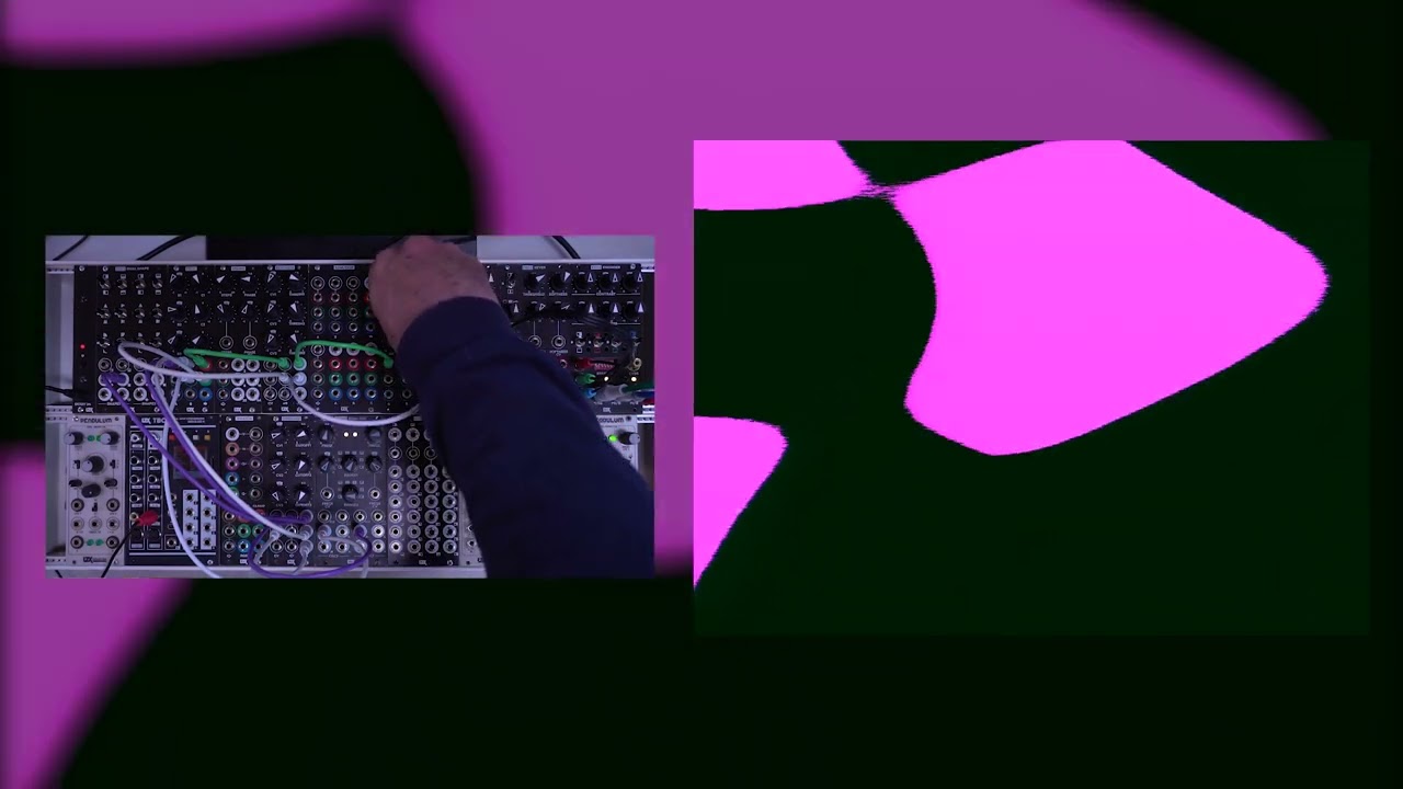

this is the basic effect
https://www.instagram.com/p/Ci5kf90pMw1/
this is contour used in a larger patch

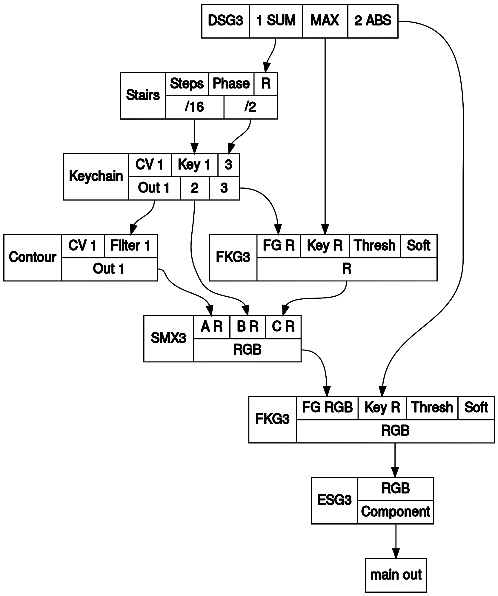

this is the diagram for our second patch.
you want to really hit contour hard with something like a keychain or something that gives you a nice hard edge. You can of course experiment with it however you want but I’ve found that a nice hard edge gives the best results. You will get something from smearing to an edge outline.

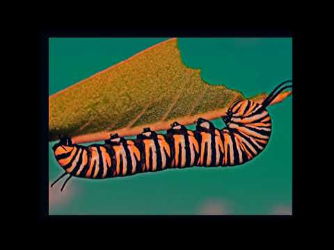

I recorded a quick video of an image going through Contour. I am using proc to blend between more/less or the Contour effect.
Like wednesdayayay pointed out, I love the way it grabs onto outlines and smears them. I am also modulating the cvs with some lfos.

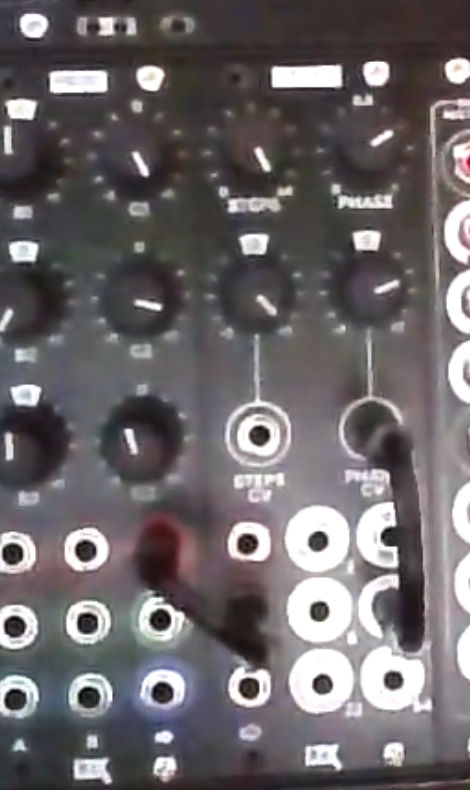

for instance Marizu talked about a noise patch for stairs a while back that people are really liking in the current noise module dry spell.
Forgive the poor quality screenshot but I captured it during a stream.I haven’t patched it up yet but I believe you patch a stairs output back to its phase CV in and send a static offset from something like matte or an empty proc channel to the G input of stairs.
