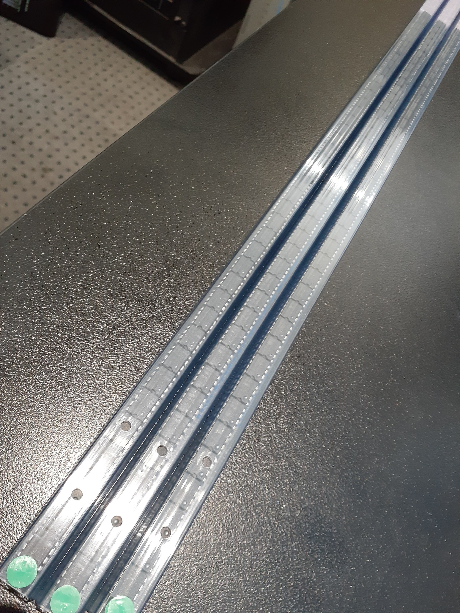

I got a batch of 120 so if anyone in Europe is in need od a few, please let me know. I’ve nearly gotten through the first 40, got 3 rows like in @VisibleSignals’s photo a couple of months back.
