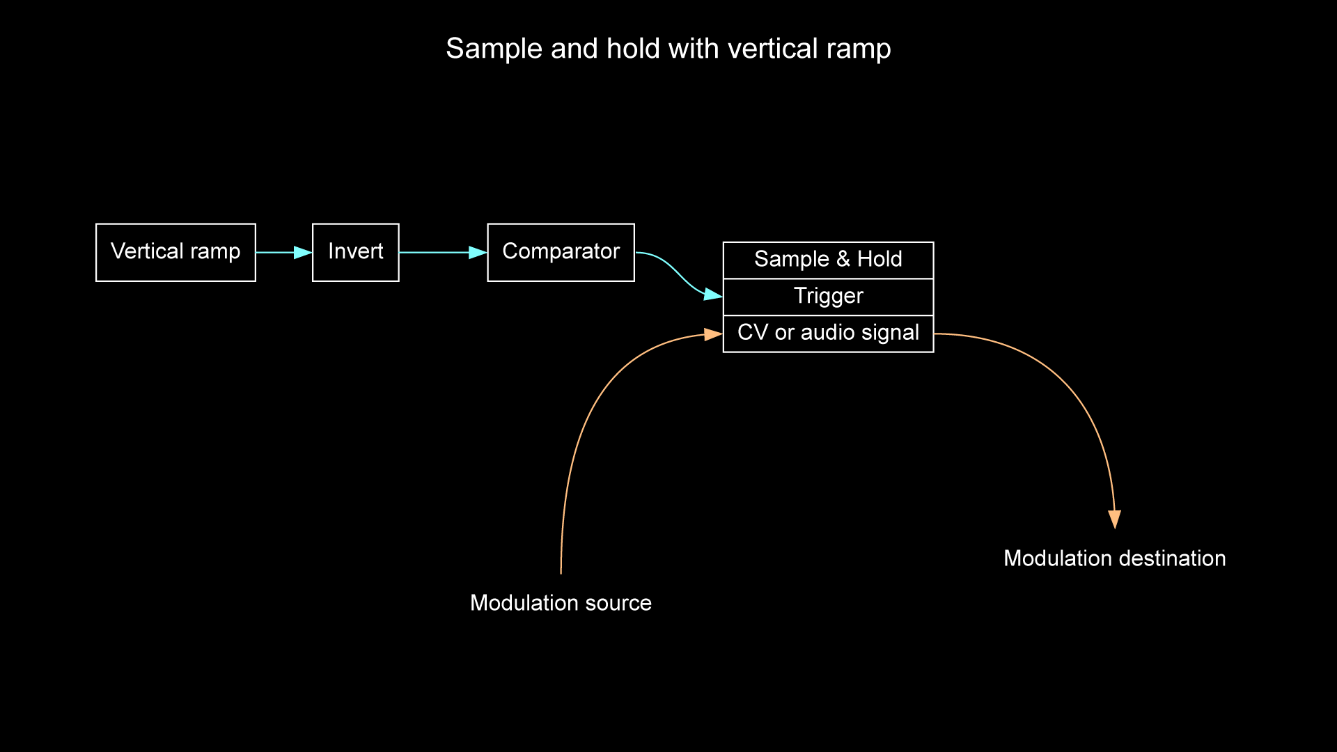

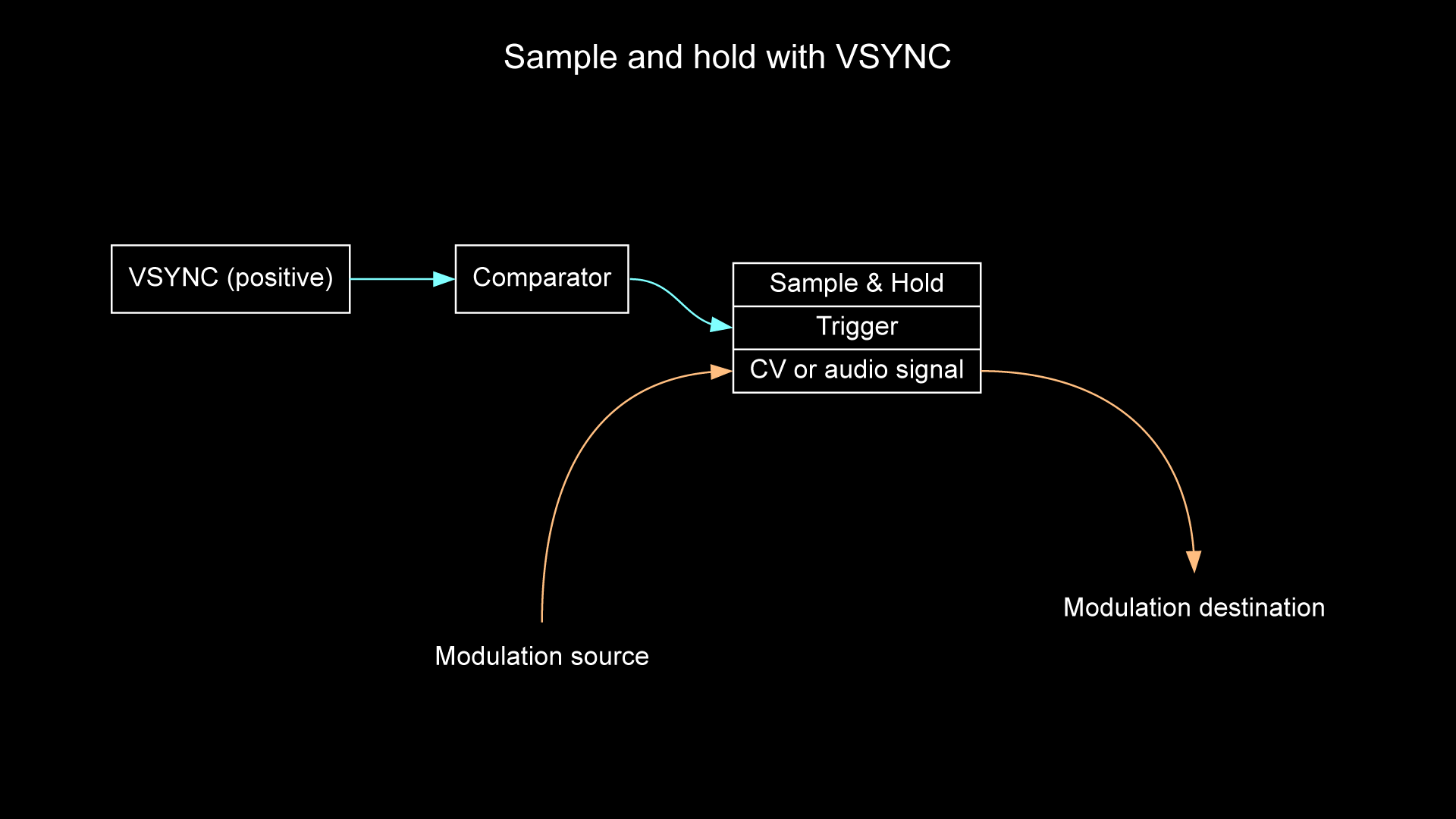

Video about Sample and Hold to prevent frame tearing and shape distortion
Video Synth Tools & Techniques: Sample & Hold to prevent frame tearing and shape distortion
Patch diagrams below
