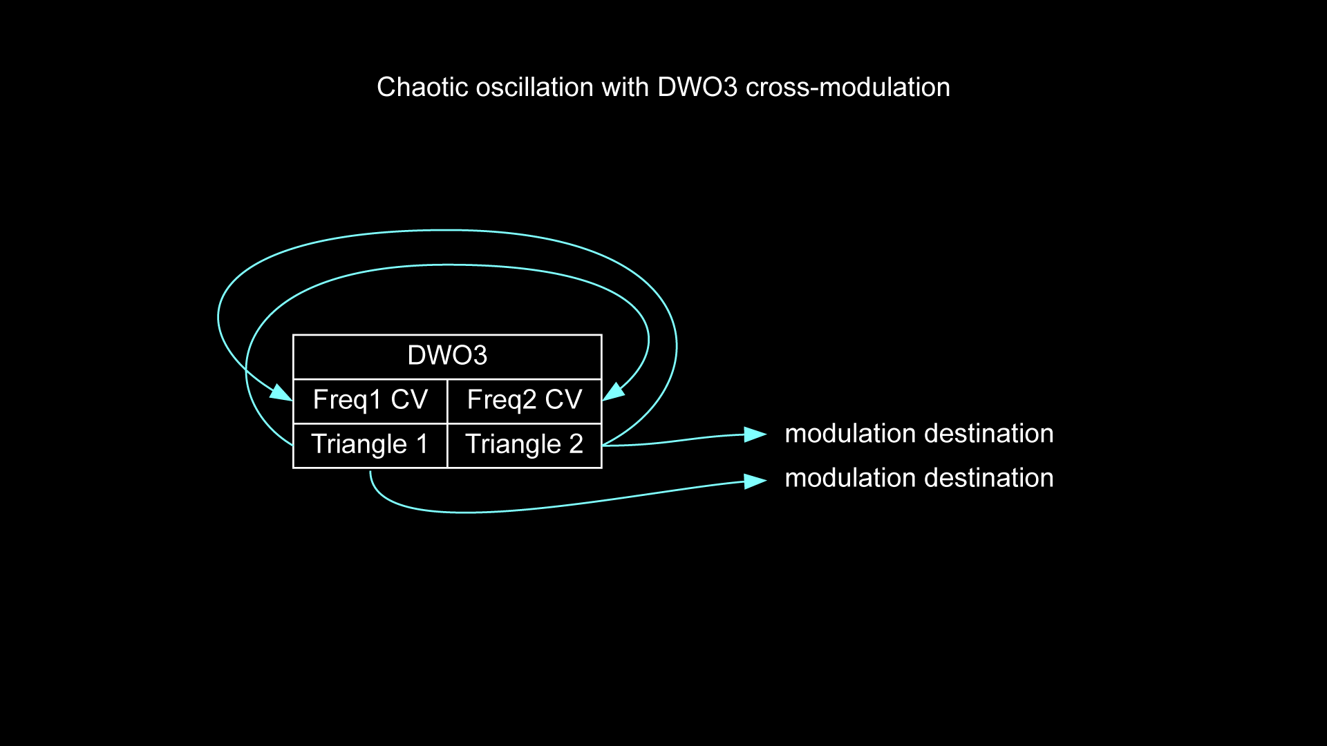

Chaotic oscillation with DWO3 cross-modulation
00:27:09

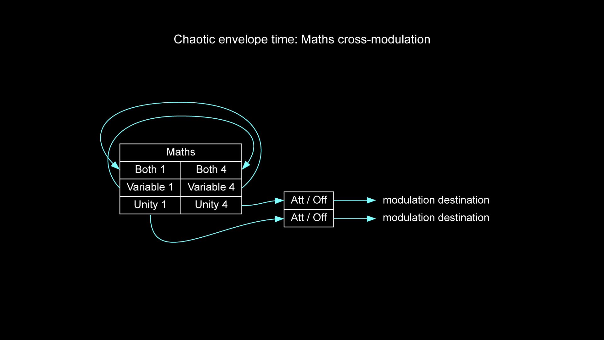

Chaotic envelope time: Maths cross-modulation
00:30:03

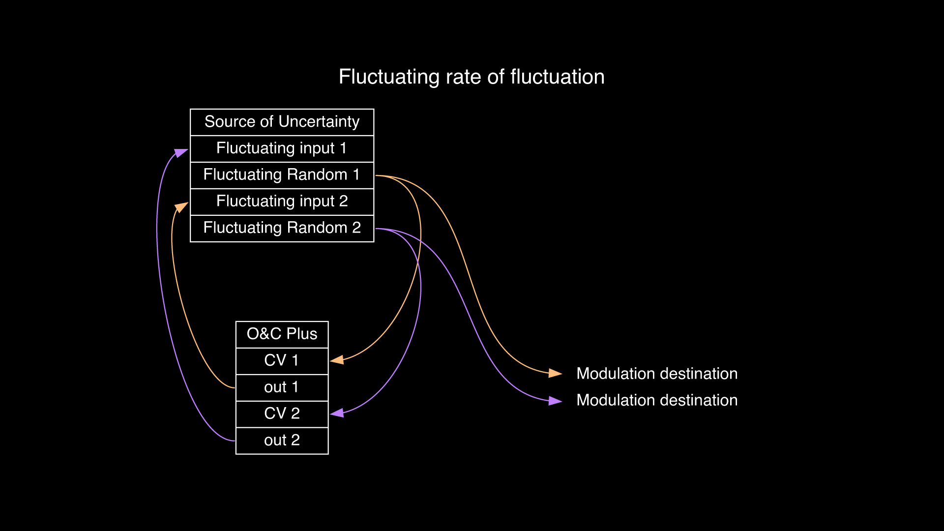

Fluctuating rate of fluctuation
00:40:41

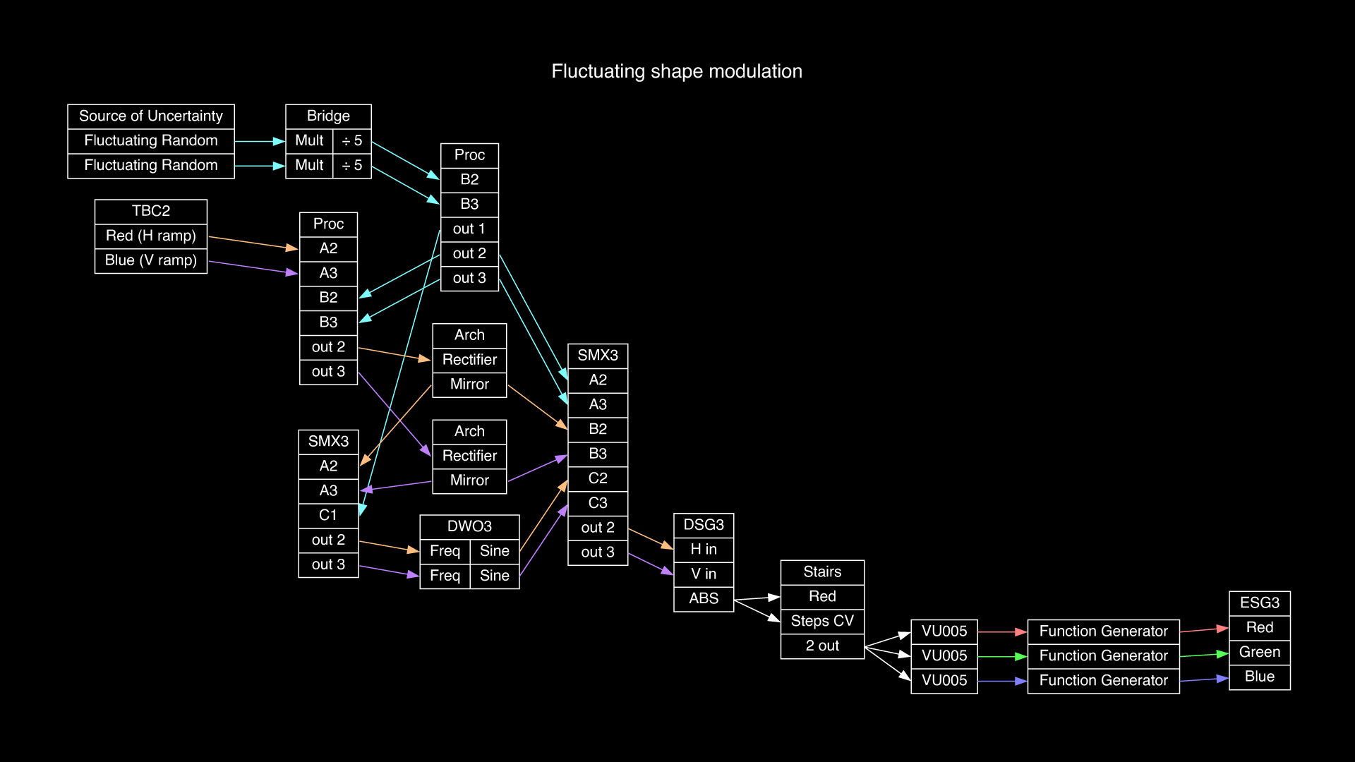

Fluctuating shape modulation
00:42:57

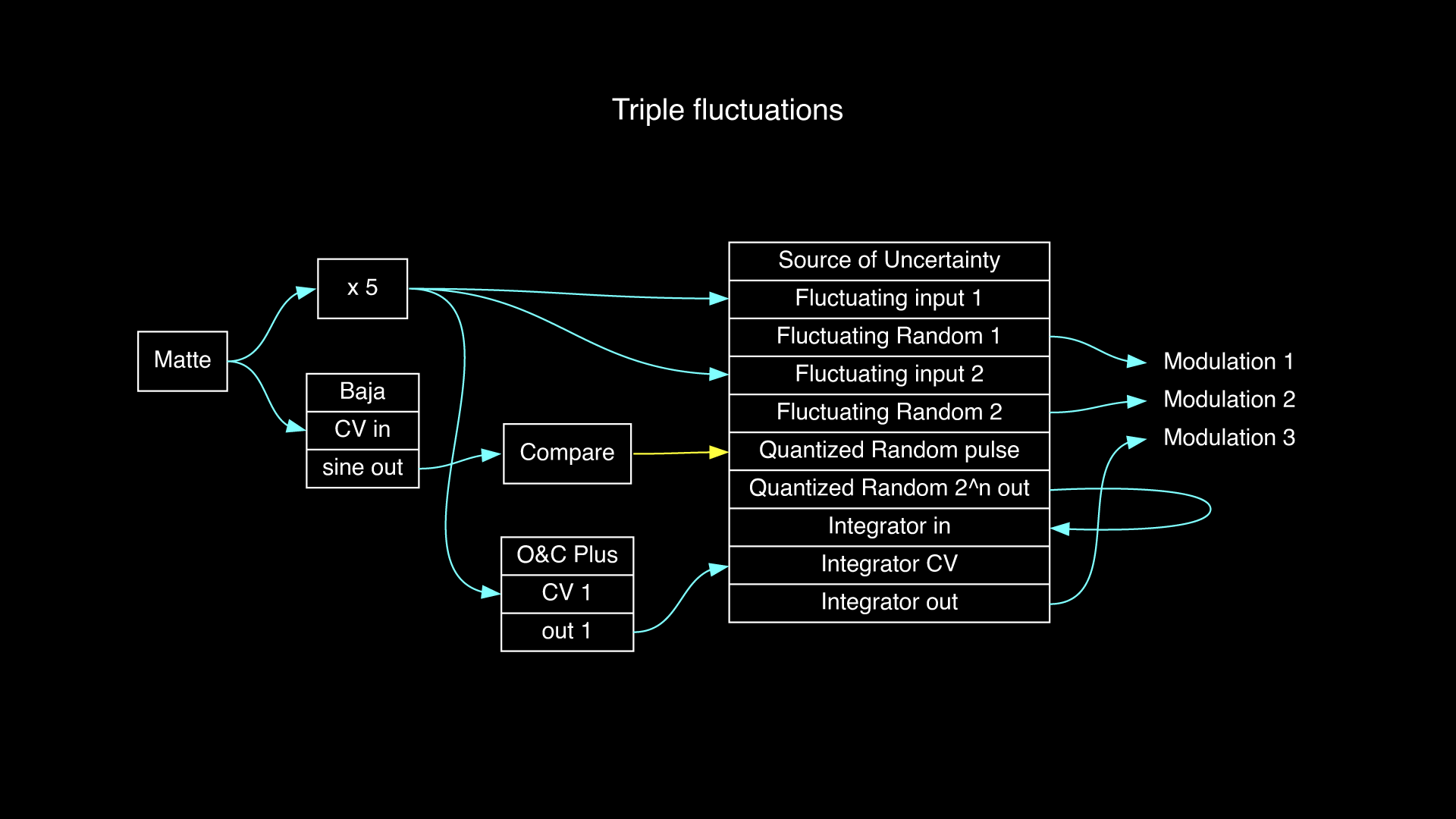

Triple fluctuations
00:48:28

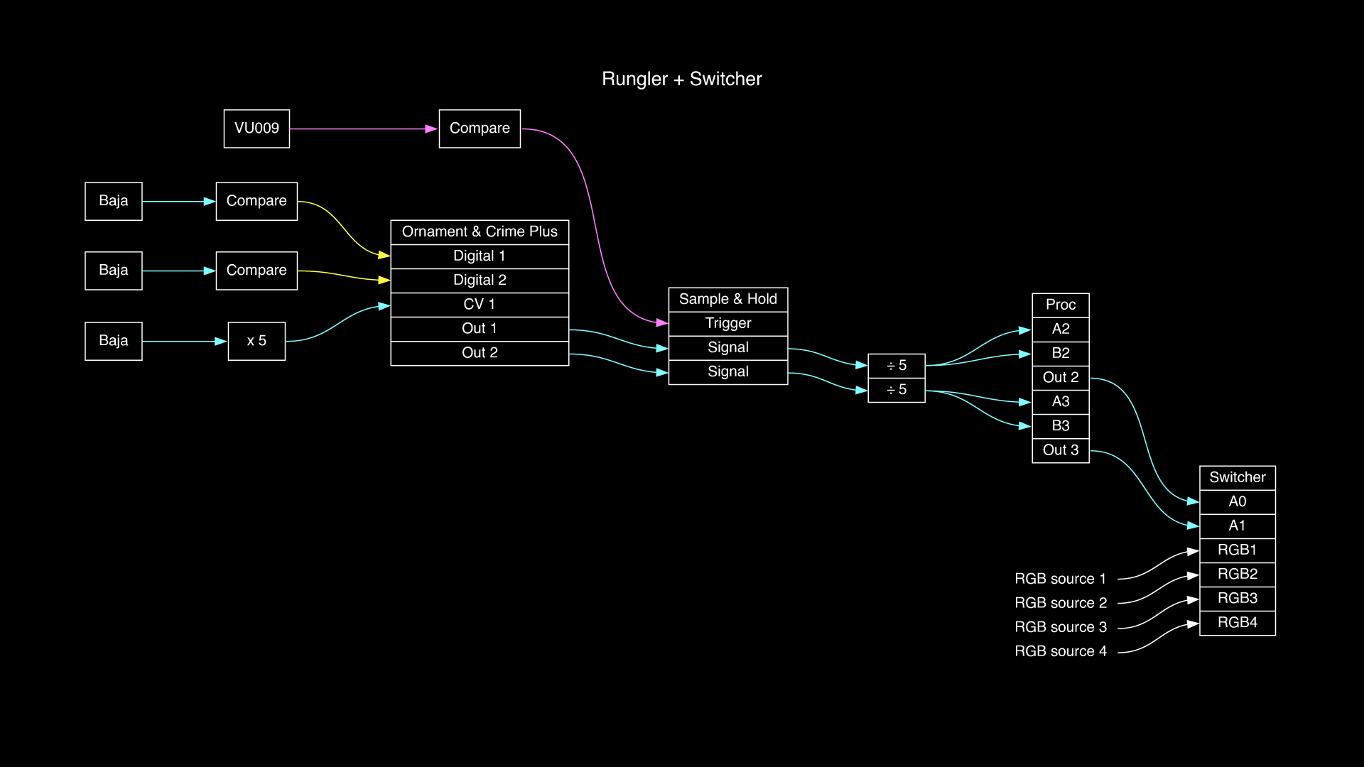

Rungler + Switcher
01:17:16

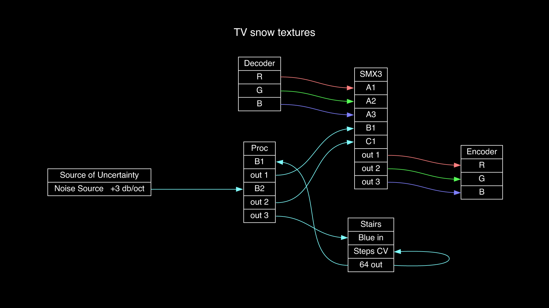

TV snow textures
01:37:04

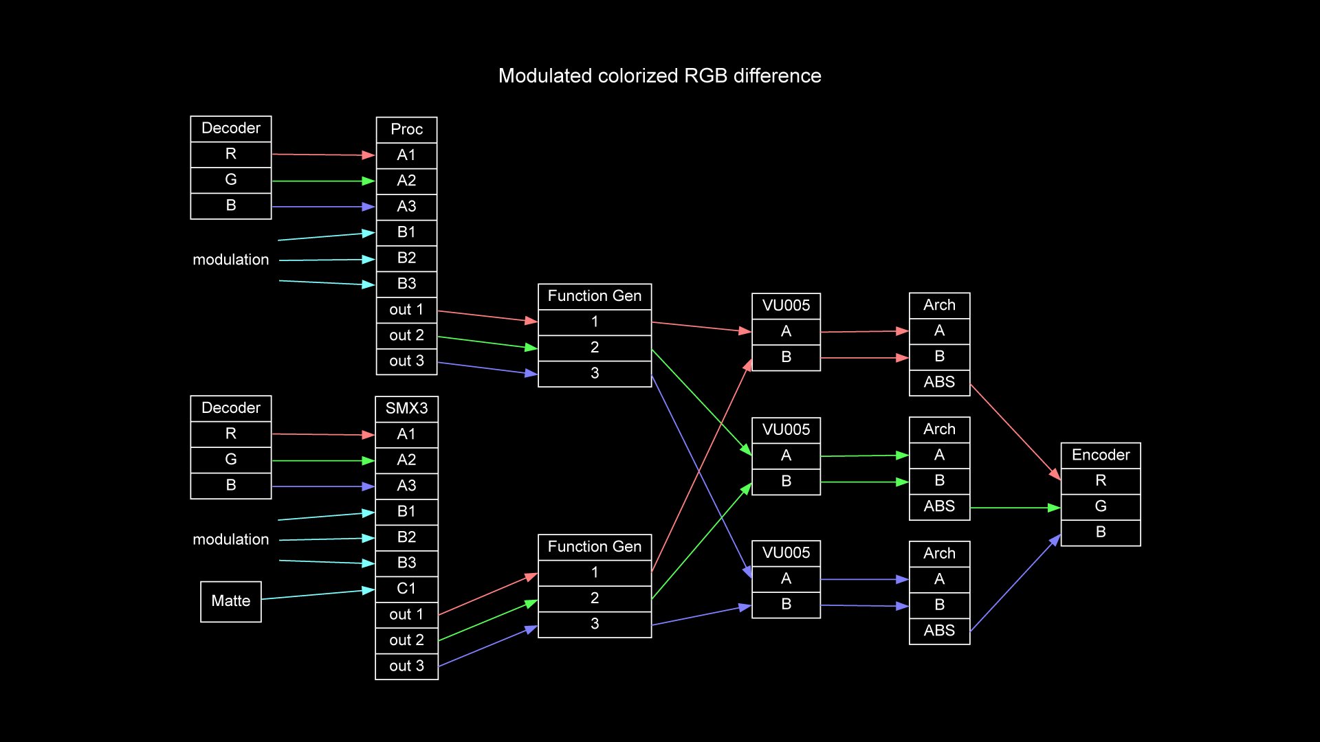

Modulated colorized RGB difference
01:39:12

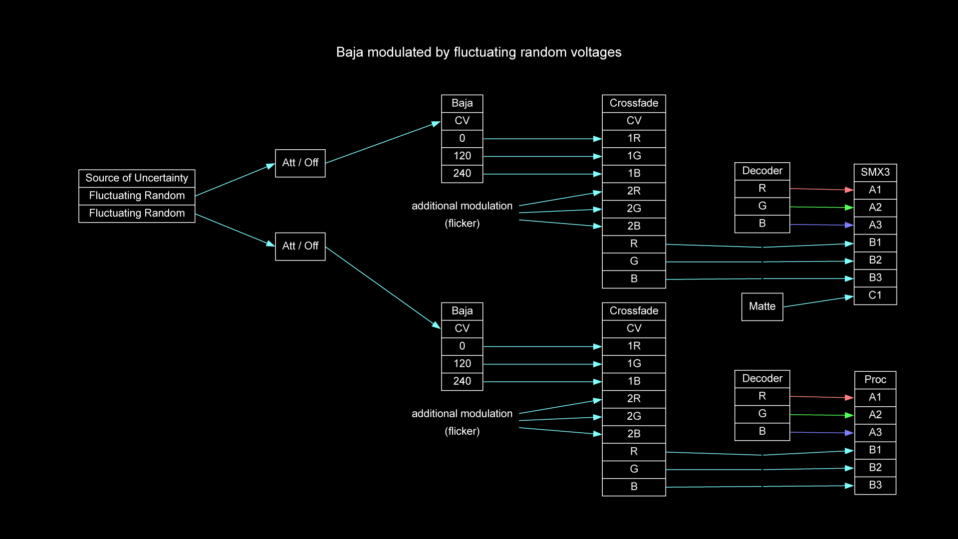

Baja modulated by Fluctuating Random Voltage
01:42:32
