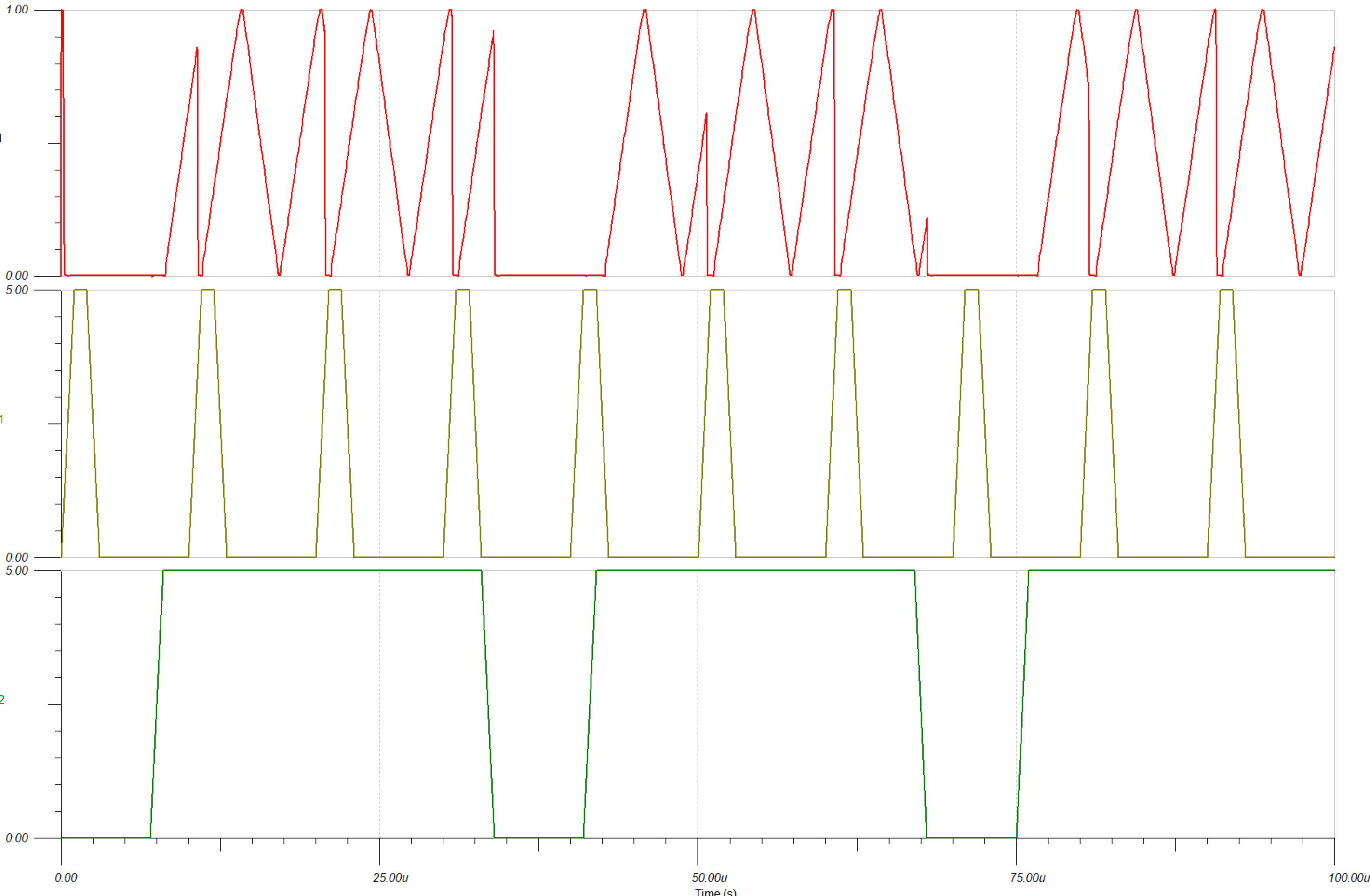

Here’s a fun look at simultaneous video sync + external reset trigger in our DWO3 simulations. The filter will work the same way. So say you’re smearing your input with a low pass – you can sync it with a separate pattern to flush the timing capacitor to black at any rising edge.

Regarding redundancy… it’s going to be an exercise in frustration to try to make things add up between series precisely. If you have an older module you like, that does a function you like, keep it. Even though it will show back up in Gen3, you may like the original way it was implemented better! I don’t know.
