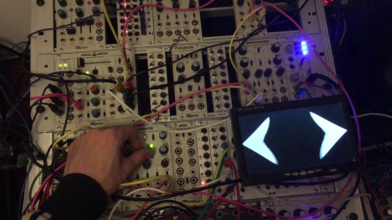

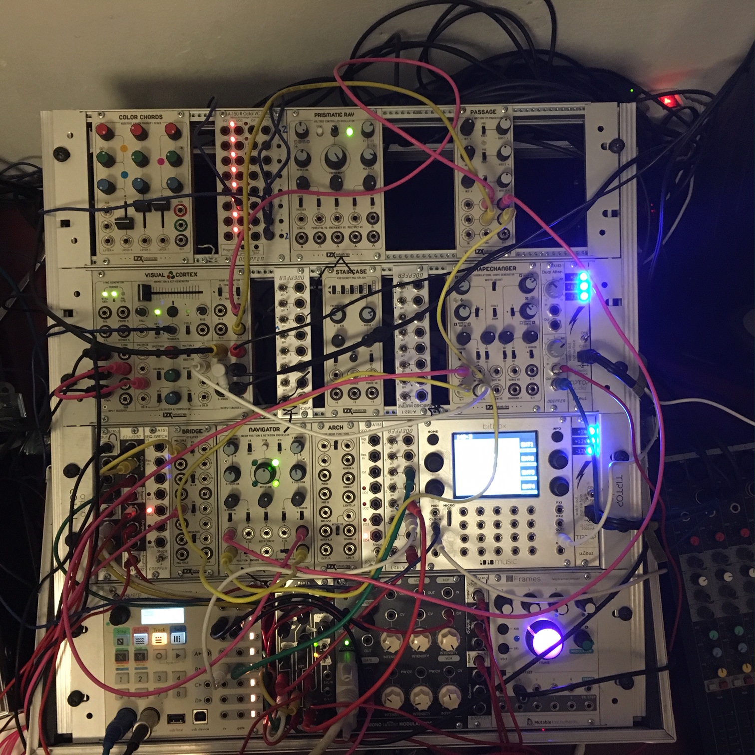

Could you post photos of your patch? And a video, if possible?
here, and thanks for all your help! niceee!
it always moves from out of the center…
the patch is (each ramp sperate, h=magenta, v=yellow) :
vc >>passage >>navigator>> [sh.ch. h and v in>> sh.ch. gradient out]>>vc. ch. b in
