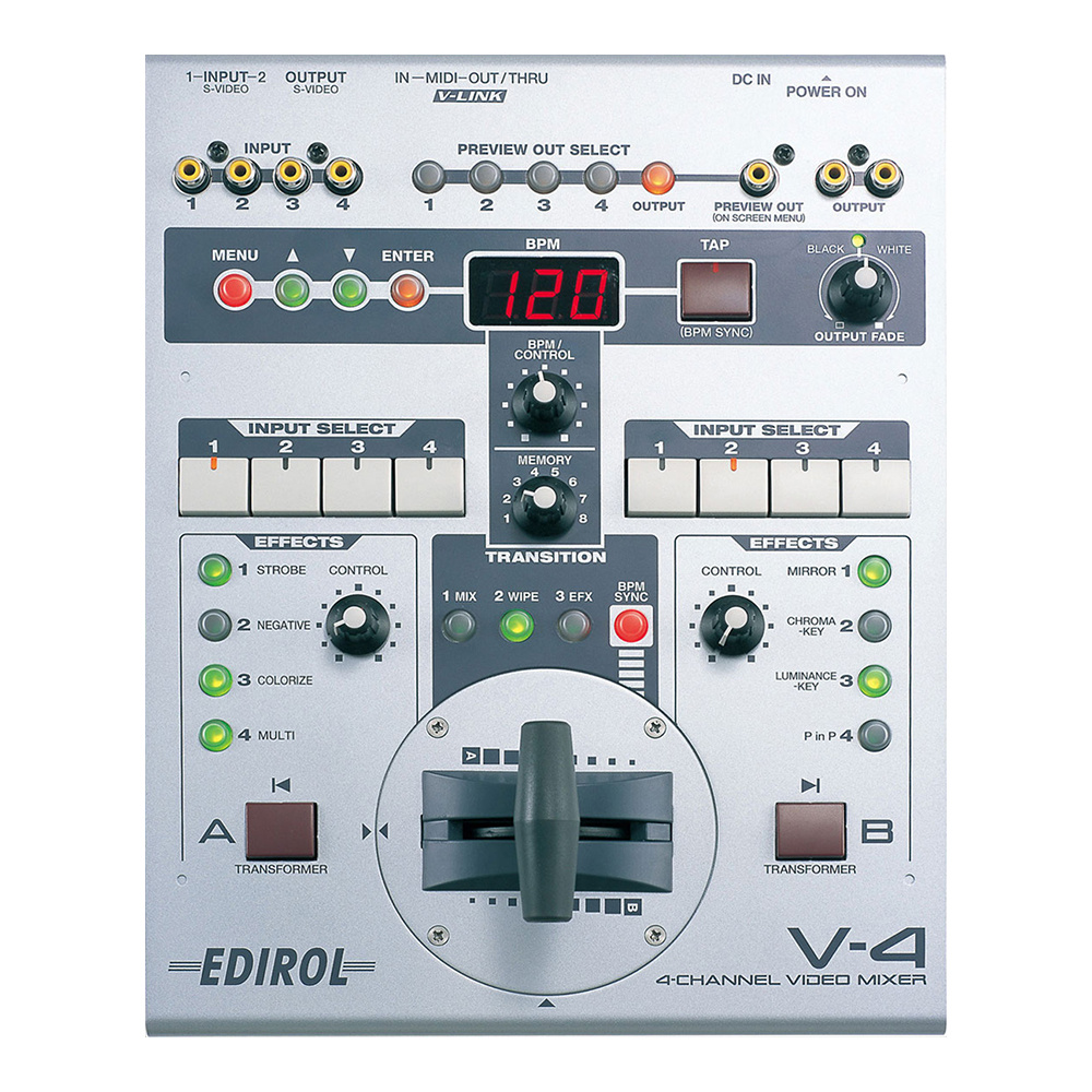

I’d love to have composite mixer or similar in the rack at some point. I know a lot of you have the fancy Edirol V4, but I simply can’t fit it into the space I have, hehe. Maybe the TBC2 would be suited for this eventually?

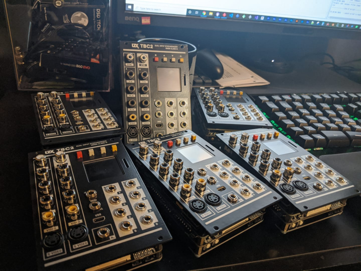

If only! I don’t think you can fit 3-4 TBCs in 2HP.
Look how thick 2x TBC is.
Oh gosh I wasn’t imagining TBCs to sync fresh signals into a system, just switching between output signals on those modules that have composite out plugs, but for a situation where they are all sending signals with the same root source/sync. I can do it at the moment but just with a few little composite-3.5mm adaptors!
I guess this might not work for Hypno (I don’t have one, don’t know if it takes slave sync), but I at least only use those other modules as alternate post processing options of stuff that always started with the VC’s master sync. I’m probably still missing something though, as I don’t have your technical knowledge!
Honestly I would really consider making the space for a V4. I can’t imagine not having one at the end of my chain. For usually less than $400 you get 4 TBC inputs, a bunch of simultaneous effects, full midi controls, main+preview monitoring and more in a format designed for live visuals… It would cost thousands to recreate most of that functionality with current and upcoming modules.
Just like in the audio Eurorack world, an external mixer is financially and functionally more practical than an in-the-rack solution - especially when it comes to integrating and expanding outside of Euro.
Size could be a compromise, but it’s also a performance interface to do try and make some space.
