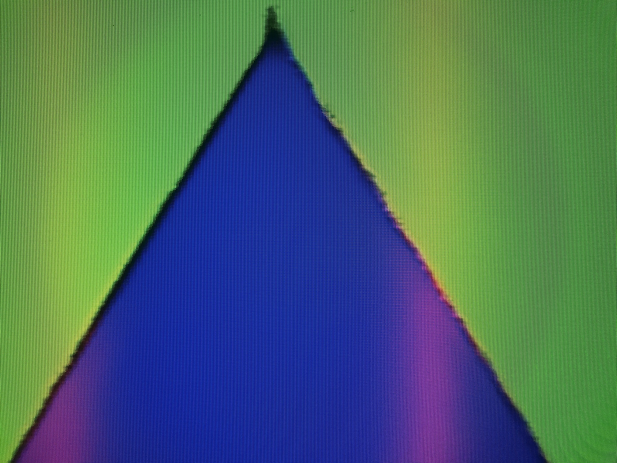

for me its not really noise, more some kind of small edges i would say… the shapes are not 100% smooth, hard to describe..i will make a visual example when i have some time. But i also have trouble with crosstalk between some audio modules
attached my kind of noise in closeup
That’s the kind of noise I was seeing on a Row Power 40. Thanks.
