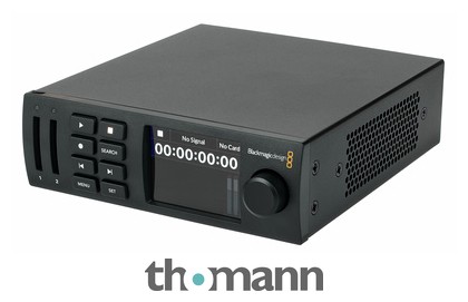

In my case, I had a real budget for gear at that time. I bought a BM Analog to SDI mini converter and a BM HyperDeck Studio HD Mini. I believe in the old saying 'buy once, cry once". I really like the HyperDeck, it has an FTP server built in, so easy to just push the record button without having to move across the room to my computer.
I have a Hyperdeck Shuttle and a 240 GB drive. That letās me record 23 mins of HD video. Unlike the Studio model, it canāt format new drives, and it doesnāt like my 2 TB drive formated by a Win10 machine. The red LED flashes and I get errors on playback. Perhaps the drive is too big. When I can, Iāll test it with a smaller drive. 500 GB, maybe.

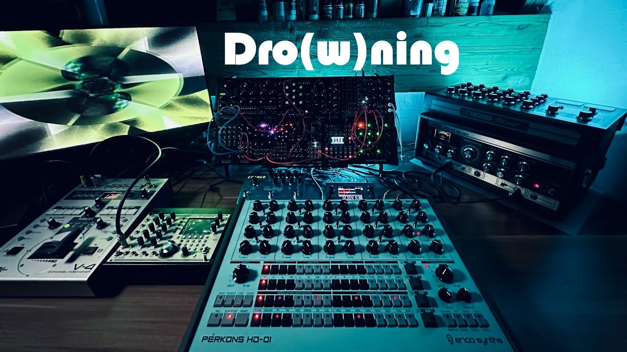

Some answers of questions nobody has asked
- but maybe it could be useful for people starting on this topic like me two months ago, saving a lot of money ![]()
I do not own any LZX-module yet (shame!)
Core modules of my setup are currently two Erogenous Tones Structure!
Capture devices mentioned here are reflecting some personal experiences for MacOS (canāt comment on any solution for Windows).
Everybody recommended the Black Magic Intensity Shuttle, which works perfectly fine, a long as you are working on an INTEL MAC. Newer M1 or M2 Macs are not supported!
For my M2 MacBook Pro (2023) the Black Magic 3G recorder is a super choice as a capture card (not even expensive)!
I made a comparison video on Intensity Shuttle (capture and upscaler) and 3G recorder + cheapo-upscalers:
Since I wanted to get away from all those adapter and upscaler-/capture-combinations,
I gave the Black Magic Ultra Studio Mini a try:
Here, I was able to capture, but was not able to upscale to 1080 (the settings were grayed out in BM-Media express, but I also failed in OBS). No Idea, what went wrong here (maybe related to M2 - I donāt know). Super annoying fact (at least for me): you her the fan running ALL THE TIME!
My current (and final solution) is the combination of a RetoTink 5Xpro and the Black Magic Recorder 3G:
Quality of the RetroTink is absolutely awesome!
Still off my to-do list:
Rescanning of my tiny 5" PVM-6041QM with a Black Magic Pocket 4k (Sigma 56mm f 1.4)

The BMD HyperDeck HD Mini does not perform any upscaling or downscaling. The menu setting had me confused as well. The manual says the Default Standard setting is for playback when a video file has more than one video format. The device always records using the format of the input stream.
From the manual:
A good example is if you have turned on a HyperDeck Studio, it has no video input connected and you insert a disk with files on it with 2 different video standards. Which video standard should the HyperDeck play? The default video standard will give it an indication which video standard you prefer and it will switch to that format and play those files.
The default video standard is also useful when you first turn on a HyperDeck, and it has no video input and no media disk inserted. In this case, the HyperDeck Studio does not know which video standard to use for the monitoring output. The default video standard will guide it on what to do.
ā¦
Itās a similar situation with recording. If you press record, the HyperDeck will just record whatever video standard is connected to the video input.
