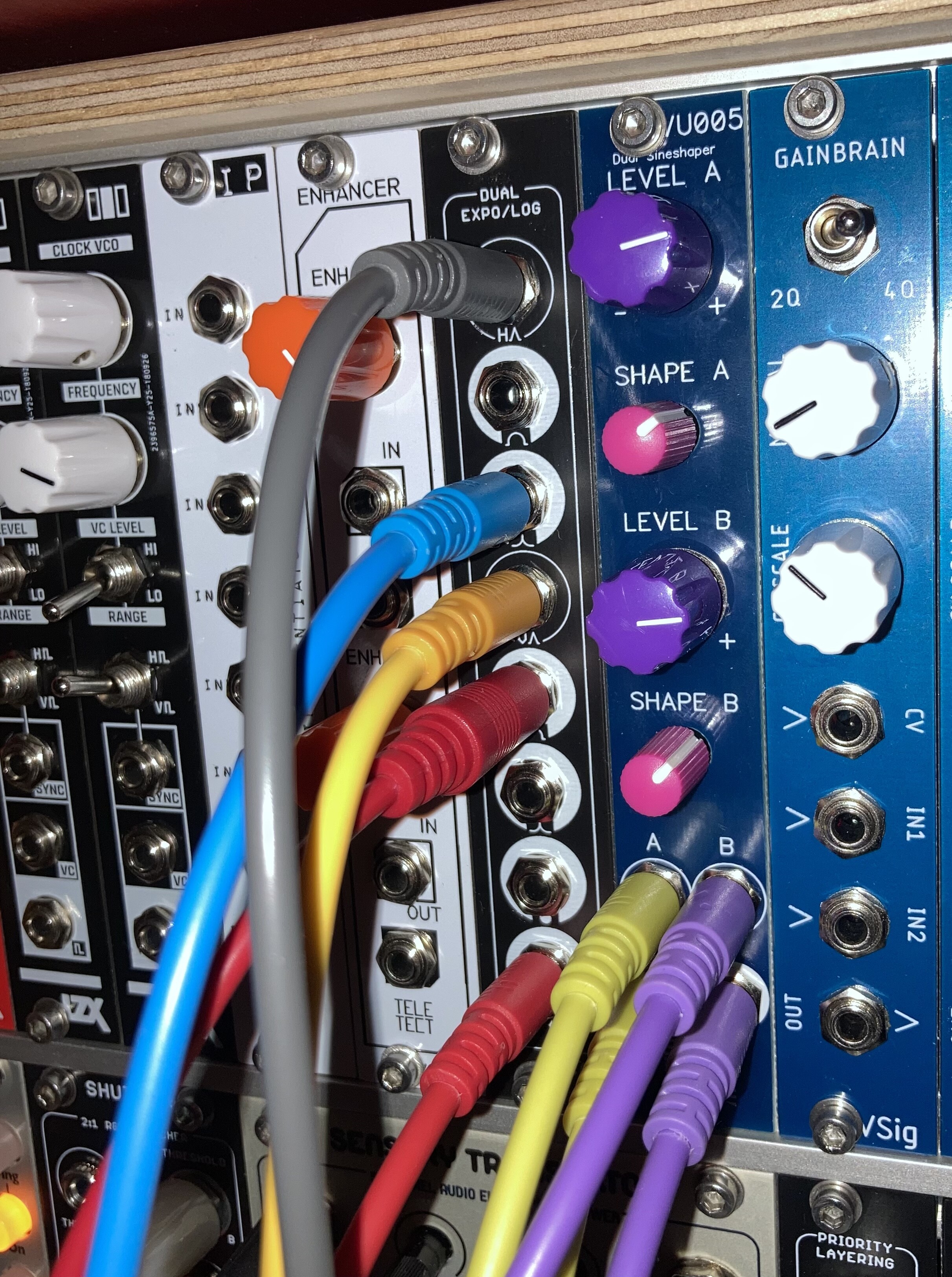

All built up and working like a charm, initially thought the labelling on the circle function had been flipped but of course cadet ramps go \ / rather than / \ !
Itâs great having easy access to functions in a DIY rig that used to only be available on built modules.
Nice set of DIY modules in your case!
Yeah, if youâre feeding in an inverted triangle ramp from Cadet IV then you would need to invert + offset it to be what the module is âexpectingâ to give you circle / pincushion star gradients on the bottom two outputs. Using the Fold output on Foxâs Dual Rectifier, you could take your regular H / V ramps into that and youâd have a positive going triangle ramp on the output to feed into Gamma.
Of course you can patch it up with whatever, itâs just two identical log / expo processors with individual outputs that are summed together at the bottom two outputs. Using triangle ramps, top log output gets summed with bottom log output for the circle gradient. Top expo output gets summed with bottom expo output for pincushion gradient.
Thanks, the drought of built modules meant a lot of DIY which has been a lot of fun!
Yeah thatâs what Iâve been doing to get the circle. Getting some nice results combining the ramps with a couple of cadet oscillators and feeding them in too. Endless curves!
