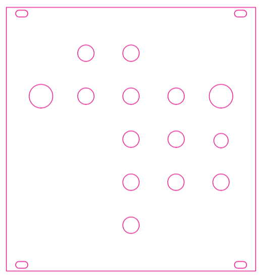

syntonie.fr works on a eurorack version of the ave mod v2.2… i already euroracked mine as well
Awesome, I’m just in the middle of stuffing the board for my AVE Mod. Do you have a panel file you could share?
yep sure you can load the laser cut files from syntonie on his github:
https://github.com/Syntonie/documentation/blob/master/AVE%20MOD/AVE_MOD_V2.2_Laser_Cut_Enclosure.ai
made this one out of it:
Awesome, thank you! I’m going to try to squeeze some labeling on there, too.

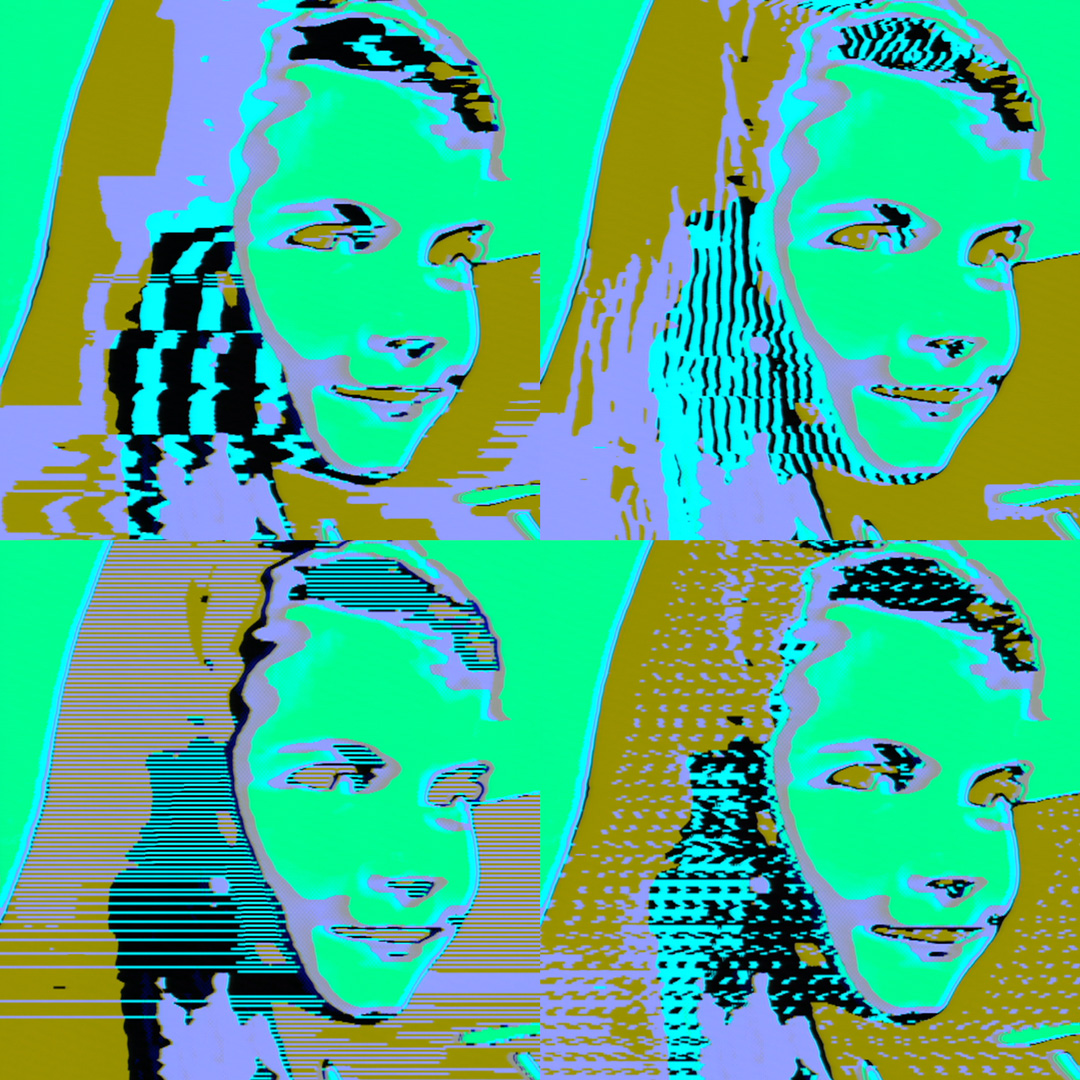

My CBV001 just arrived this afternoon and, wow, so far loving the different flavors of edge feedback possible with it. I use feedback a lot in my LZX system, but it often tends towards one specific look. Whereas pretty easy to quickly dial in a lot of variety with this little guy. Great work, @syntonie!
(Above images use CBV001 in combination with Cadet Hard Key, Castle ADC, and Castle Multigate.)
