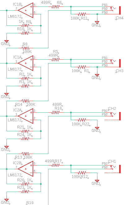

Buffered Mult, is this correct?
It is to reduce settling time , as per LM6172 datasheet (https://www.ti.com/lit/ds/symlink/lm6172.pdf)
REDUCING SETTLING TIME
The LM6172 has a very fast slew rate that causes overshoot and undershoot. To reduce settling time on
LM6172, a 1kΩ resistor can be placed in series with the input signal to decrease slew rate.
^^^ Bastien’s advice is solid, definitely put those series input resistors back in…
Merci Bastien :+1:t3:
I’ve got to read the datasheet again. I’ll pick up more next time as I’ve learned alot on here since first attempting to take in all the various info there.
About daisy chaining using the switch from a jack, best is to take the output of the op amp (before the output resistor) and connect it to the switch pin of the jack.
Not sure if a resistor is needed in between, as it will only be connected internally. Didn’t used such resistors in VU002 (where full wave rectification stages are daisy chained).
Taking the output of the circuit (after the 499R) will work too, but will be a little bit more attenuated (as each input connected will add a 100k resistor to ground), though there is some “headroom” since 499R is quite small compared to 100k (meaning it can be connected to multiple inputs without too much attenuation).
Again I agree with Bastien’s comments. But one note of warning - in my Quarterizer module I took the output from each input’s buffer op-amp directly to the switch pin of the next input socket, and it caused problems with ringing on the third and fourth inputs, even when I used a small series resistor. But, since that doesn’t happen on the VU002 it’s likely that some other aspect of my circuit was contributing to the problem. My fix (which probably isn’t appropriate for a buffered mult) was to configure the buffer op-amps for 2x gain (which the design needed anyway) and then use a 100K/100K voltage divider from the buffer/gain op-amp into the next input, like this:
Until you build your whole circuit you probably won’t know for sure what the potential problems might be. I recommend bread-boarding and prototyping all your circuits… sometimes even a simulation won’t reveal the problems you might experience.

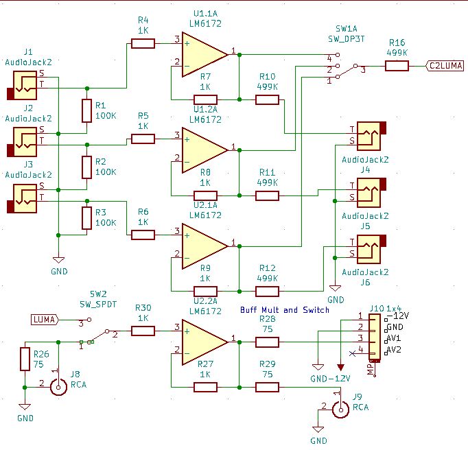

There’s a couple issues going on there but have a quick look at this single buffered mult schematic and see if the solution jumps out at you:
One quick question–where is SW1A and R16 heading off to?
EDIT: Oh whoops looks like I got this in after your post was deleted. Hope this helps, anyway!
A luma encoder! I had the idea after building the Telewizor and thought to myself, the circuitry to the monitor is actually extremely simple. I read through this forum thread and thought it would be nice to incorporate an encoder into the preview.
Being that a lot of the heavy lifting of the design is already completed its more of an opportunity for familiarize myself with KiCad and try to understand how the encoding process works. I’m currently laying out the cadet RGB encoder and planning to normal the RGB channels into the encoder for a monochrome output to CBVS. Once that is done I will start a new thread asking for help from the community to look over the design for glaring faults.
This is the portion of the circuit that will switch/mult the luma in and switch between the CVBS video streams.
Also there were some mistakes here that are updated now thanks to Fox, I have a bit more figuring out to do on the rest of the schematic, mainly using RCA sync instead of 14 pin, so once its not totally messed up I will post the full schem.
